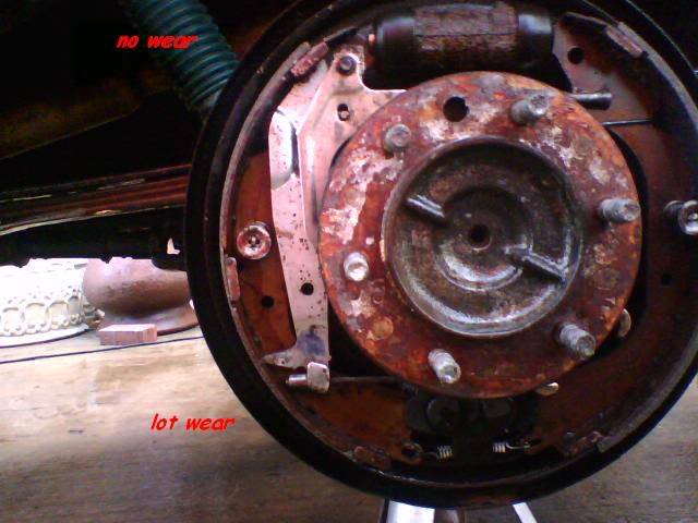

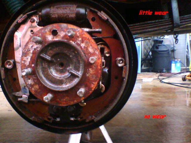

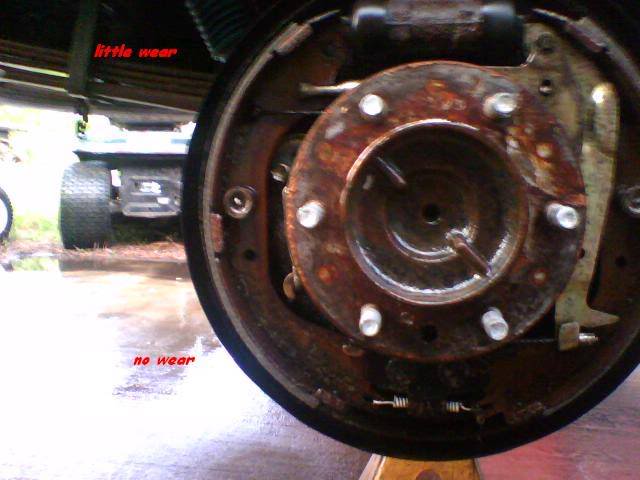

hey guys.. i was cleaning out my truck yesterday and rembered that the guy i bought it from gave me a new set of rear brake shoes. so i decided to put them on today, i got the drums off and noticed that the factory pads were worn wierd, i think?
let me know what you think..
drivers side..

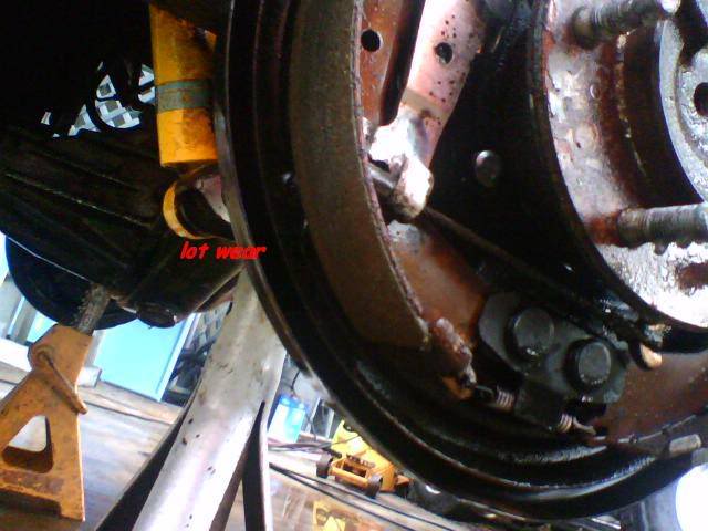

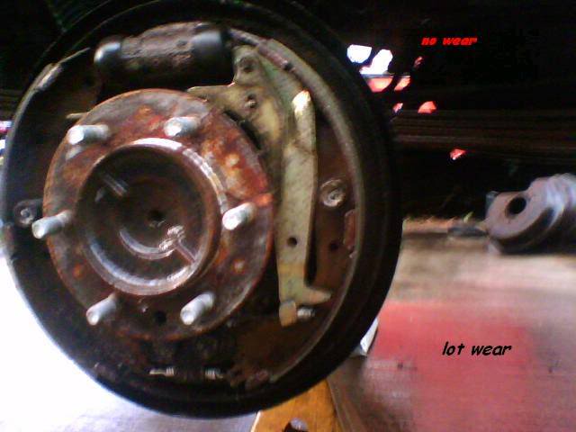

passengers side...

Pretty much normal wear pattern for the rear shows.
Note that you have a leading edge and trailing edge, along with a leading shoe and a trailing shoe and they will (and do) wear at different rates.

Looks normal to me.
When re-adjusting make sure the shoes touch after you turn the tire a good revolution. Should turn about once then drag.

Not trying to disagree for the sake of it. But they shouldn't be worn so unevenly. It looks to me like they have been run for quite some time without being adjusted properly. One shoe wearing quicker than the other by that much is not a good sign. Mine don't, they are well worn, but pretty evenly. I make sure they're adjusted at least every month or two, I know it's a little much but...
Looks like your getting close to the 1mm minimum thickness on one shoe, while the opposing shoe is like new and shows little wear. Correct me if I'm wrong, but it appears this way on both sides driver and passenger.

mudhippy, your correct.. the wear marks correspond on both sides..
i just seems odd to me because the piston is at the top of the shoes, so common sence would say that the tops would wear first?
also.. i not 100% sure how the new shoes are placed... theirs little letter and numbers on one side of the new shoes edge.. i asume the lettering faces out?

That's the way I imagine it too. Because they were never adjusted tight enough at the top(where they adjust)they wore quicker on the bottom on at least the one shoe per side it looks like.

Uneven shoe wear isn't anything to get all worked up over. Just replace them and be done with it. They are servo-action, meaning that the rear shoe forces the front shoe harder up against the drum when rotating forwards. Hence the extra wear on the forward shoe. If you're lazy, you could simply replace the worn shoe. Of course, check the wheel cylinder for leaks, clean up the backing plate where the shoe contacts, and flush your brake fluid. Also sand the rusty lip off the inside of the drum. We usually use 36-grit and do it by hand. If it's a big lip, you could use a grinder :o
When setting your shoe clearance, set it so that you can just hear it scuff when you spin it by hand. Apply the brakes a few times (make sure BOTH drums are in place) and then re-check your clearance. A click or three too much in either direction of optimum are just fine fine.
FWIW, on old hondas, you could buy shoes individually from the dealership... so you could just buy two shoes to replace the ones that wore out
