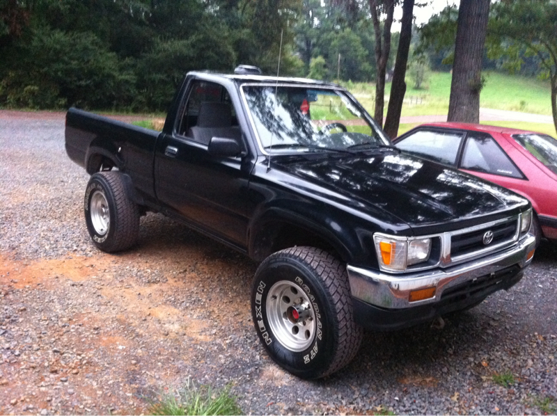

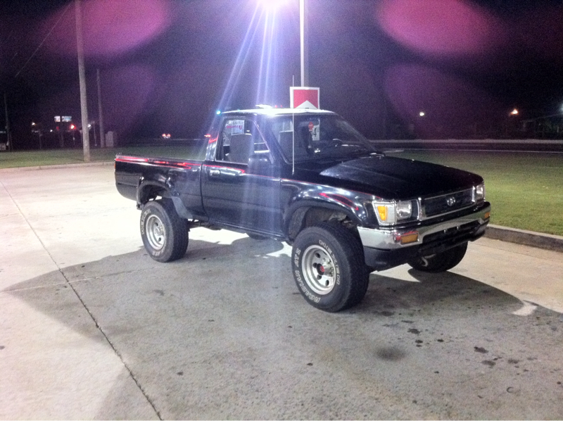

My 94 forced induction options.
Okay guys, My rig is way past due for a rebuild,(just more of a reason to build what i want) and Ive been looking at LC engineering page dreaming about the turbo or supercharged kits.. Has anyone bought one? Which is better? Thoughts?or any other parts I may consider
94 4x4 22re 5spd

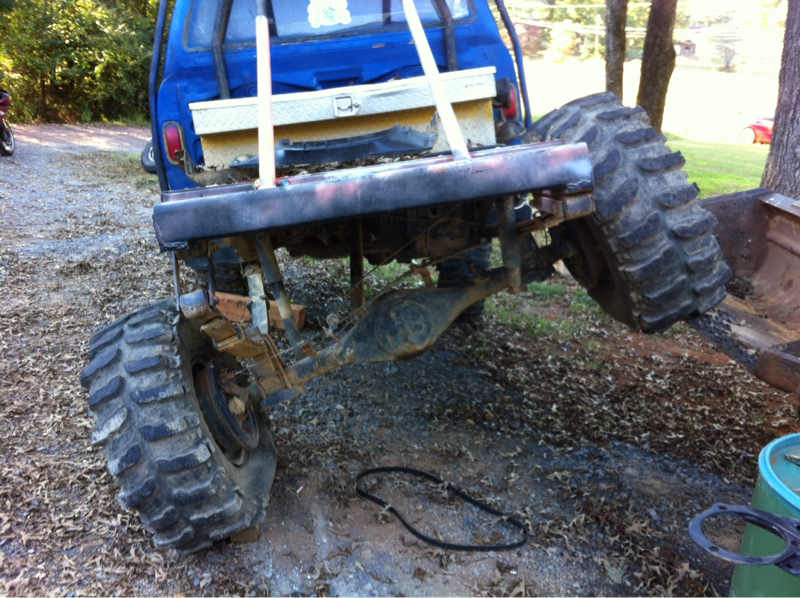

Ahh, expensive? How hard is the change?
A few of my crawler 91 with land-cruiser Sas
