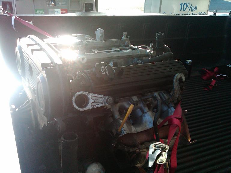

hi everyone, I was surfing CL yesterday and found this long block 3vze for $100. I am going to used the heads and the infectors on my 95 4runner.....this block have a broke main bearing cap....can you replace this part from another engine?

Kind of, but it probably shouldn't be done. Normally those are machined to fit only the location they're originally made for. You would have to plastiguage everything in order to make sure it would have the proper oil clearance.

Great find! Yeah, if you replace the main bearing caps, they have to be line bored & honed to fit the block. It can be done, but if the clearances don't match up perfect it will most likely end up destroying the block (eventually - could last 1, 100 or 1,000,000 miles...)
