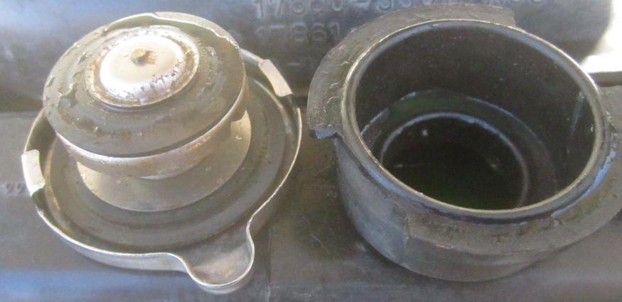

Is there a rubber gasket on both surfaces of the radiator cap? (inside and for top of neck)

Yes, gasket on both. Here's a photo:
