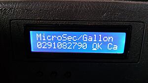

I've got some new calibration settings for y'all.
New Ms/Gallon setting.
A 4.04% difference overall. This means I actually got closer to 24.4mpg on my way down to San Diego this past weekend- with the top off. Pretty darn smitten with those numbers looking at the odometer reading 491k Granted, I think there's no way it is the original engine. Besides a small starting issue I am having it runs like brand new.
