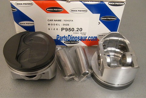

Here is a picture of Rock 3.0 pistons. Under the "P950-20" is says .3mm DECKED. There is only one piston style offered by Rock for the 3.0 and the 2.4 truck motors.
The ITM catalog shows two sets. Standard height and DESTOKED. Many companies don't offer the choice and only have destroked.

Trainwreck, my pistons are ITM, the box says: ITM No: RY2795, Model: 22RF, Size: 020
no mention of destroke or a "D" in the part # or spec on the box...this might be where things went wrong...no destroke on the new pistons, they never gave me the option. Can you help me verify this info?

I found the ITM buyers guide, and it looks like my pistons are stock deck height, not destroked .022. They're only like $20 for the set. Guess I have some issues to take up with the shop. In their defense, the bores, crank, etc are well done...I just came in and dropped the stuff off, assuming (there's that evil word again) they would know not to go crazy on the deck, and I asked them to deck with the cover on. I think people are generally oblivious of such details and need firm direction that I failed to give.
