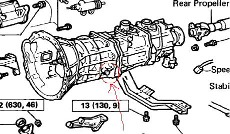

I am a farelly new toyota 4runner owner.
All I want to do is add some tranny fluid. The problem is I can find where to put it. I have looked all over and I know I am probably being a dumbass. If anyone has a diagram that can point it out to me. I would really appreciate it.

No dipstik. There's a bolt on the driver's side, sits about halfway up the side of the transmission, where you refill. You're also supposed to get a new washer for that bolt whenever you do this.

Since you don't know when the transmission oil was changed last time, I'd suggest just changing it instead of refilling.
