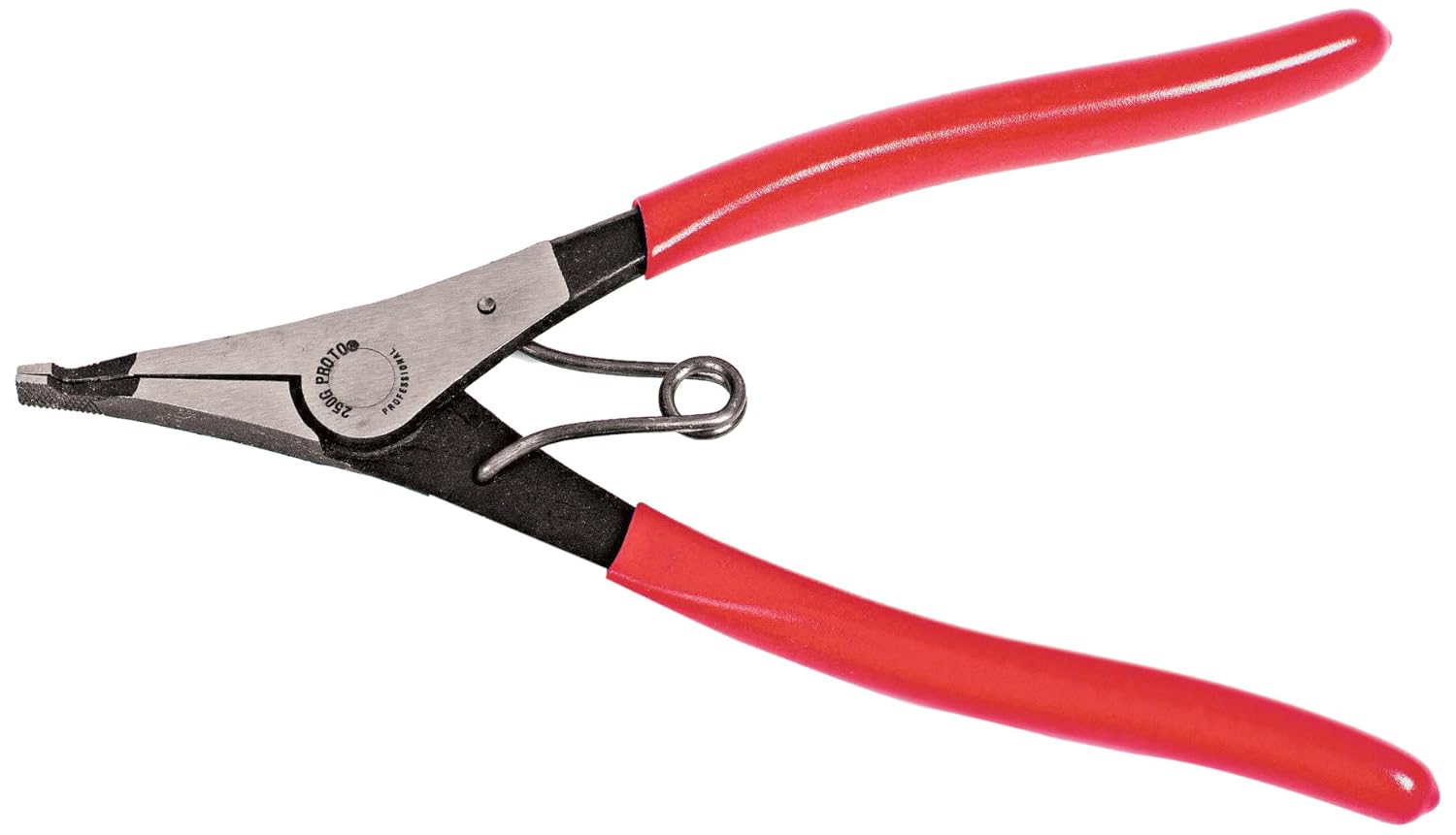

I replaced mine today, it was popping out of 5th gear. I've speed shifted too many times (that Saturn didn't have a chance) even chirped the tires going into 3rd a couple times. I have a tip if you can't get the shifter retainer to turn. Get some Horseshoe Washer Pliers, like these...
They grab and turn the retainer easily. They also come in handy for brake horseshoe clips, which is what they're made for. No more popping out of 5th, the old one was mush. Parts cost $20, shipping $12.60 takes about 20 minutes.

These pliers made it a 2 second removal and install of the retainer. I was getting ready to modify a tool to do it but gave these a try first. You just grab the retainer at the flat spots, push down and turn. Surprised the FSM doesn't say to use them. The only thing that made me mad about this job was the high shipping charge from Marlin, didn't even get a decal with it.
