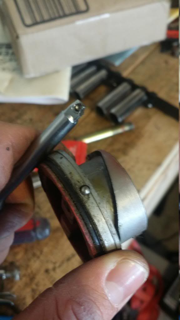

This is just an fyi for anybody who lost the ball in the manual hub dial....
I bought a $3 1/4" drive small extension, and ground out the ball there. It is, a perfect, fit! So, for anyone who has lost that ball inside the spring on the manual hubs dial, this is the solution. Thanks goes out to Terrys87, now a super moderator here on YotaTech.

Bicycle shops usually have a selection of different sized loose bearing balls.
