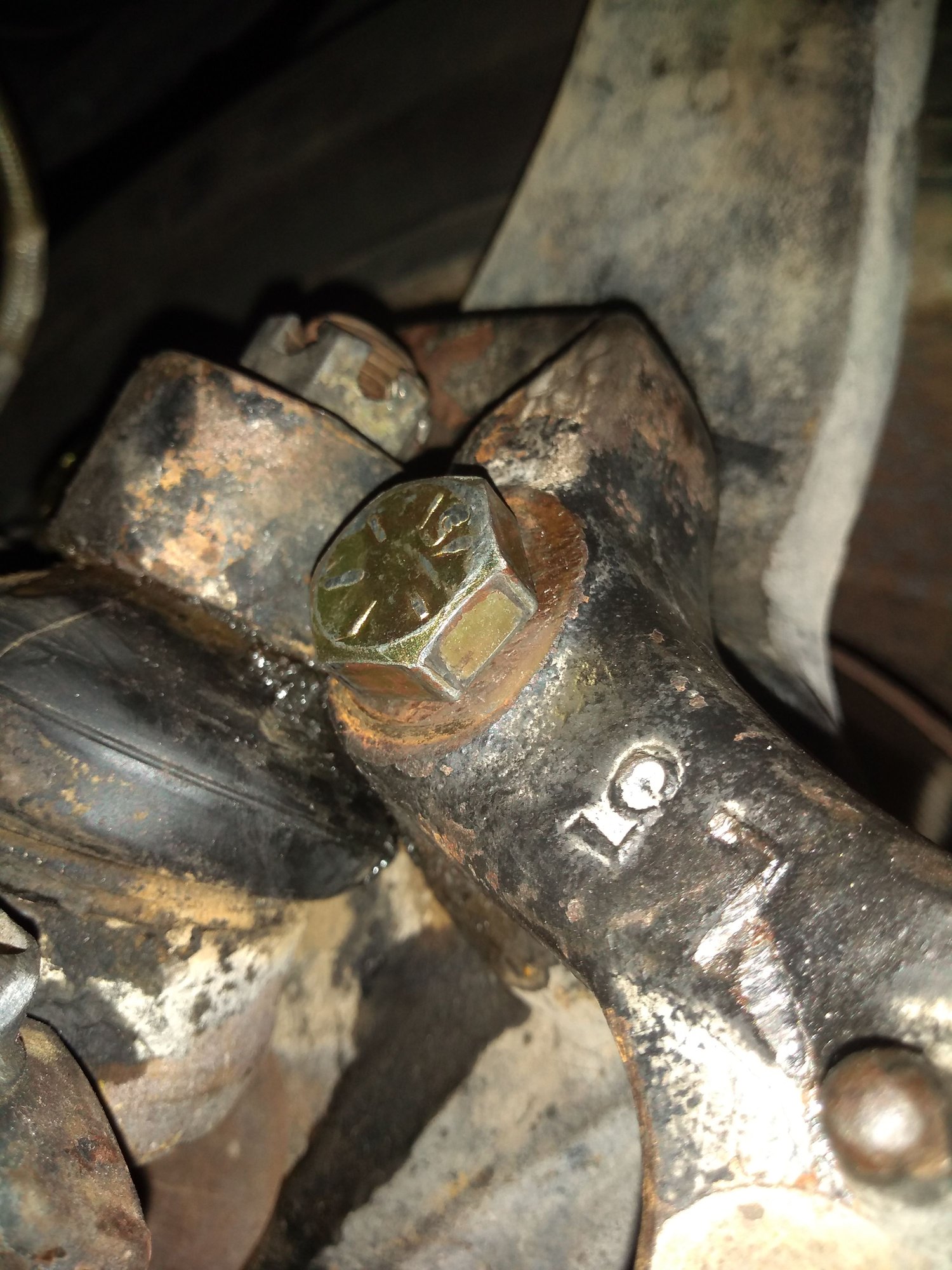

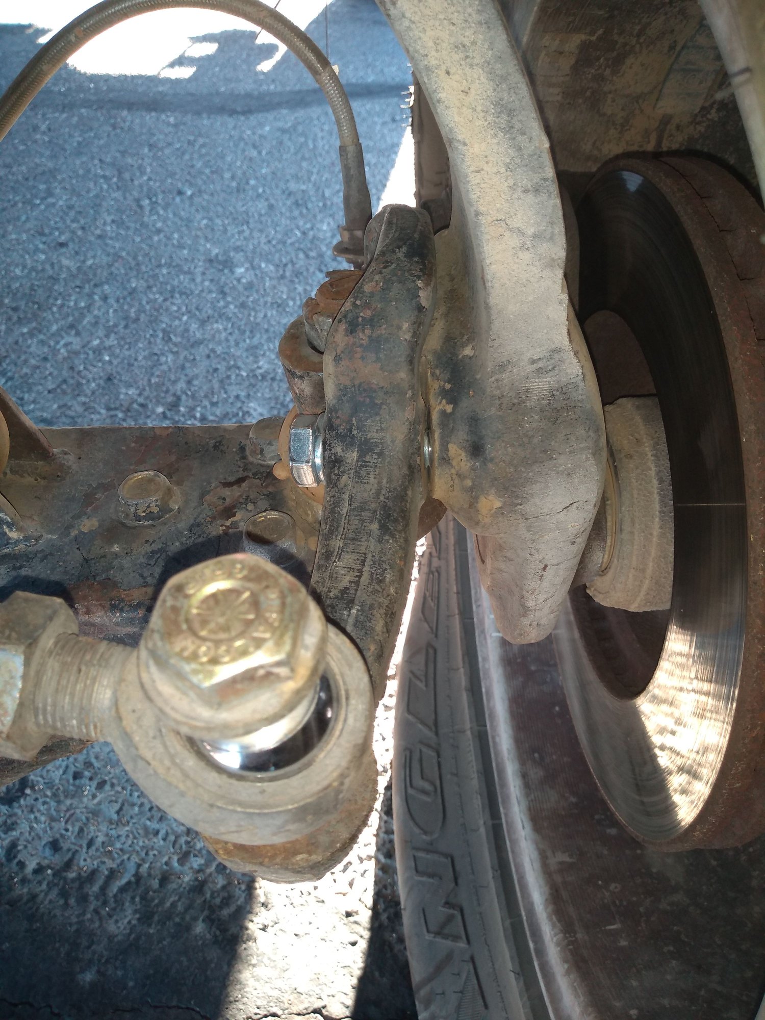

Rest assured the truck is staying in the parking lot lmao. But here's some better pics of what's going on here.
Ball joints on both sides have literally hammered themselves loose
The \"part" I'm referring to is the part that the tie rod ends attach to... I'm used to seeing them casted into the spindles. They are both bent, and they've stretched the bolts

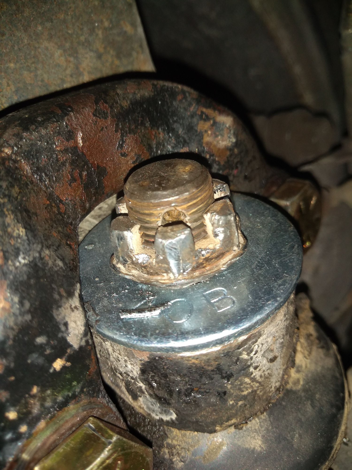

I made a few mods that fix my bolt stretching issue. And a "quick fix" to my ball joint/spindle issue. Not the correct way but it gave me enough threads to draw the ball joint tight again. Till I can find new lift spindles. Yes I put cotter pins in them, just took a pic of the fix before I completely finished them

i just drilled and tapped mine for 1/2x13 bolts. Had to put the arms in a hydraulic press to straighten them out enough to get the bolt holes to line up porperly. They were so far out of whack if I tightened up the front bolt, the back one had a gap big enough for my finger to fit in. But that problem is solved, just need to fine new lift spindles and castle nuts. The washers are keeping the ball joints tight for now though

The grade 8 "equivalent" would be a 10.9 bolt. All I could find in my size was 8.8. so I just stepped up a size in sae, that in itself is stronger, then used grade 8. So that issue is resolved. My issue wasn't the ball joints themselves, they are actually still good. The ball joint stud is loose inside the spindles. They got hammered so bad by the trails the nuts look more like lug nuts (the beveled edge) and the no longer had enough threads to get tight. So I just put a washer on top to give the nut some threads to pull on and make the ball joint tight. I really need new spindles but this is working for now
