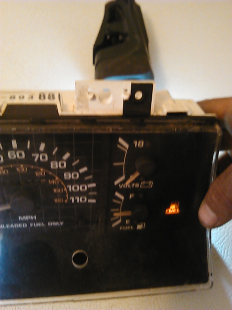

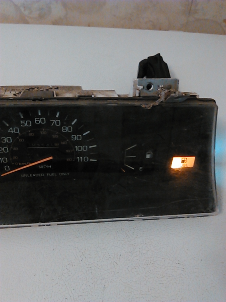

My 86 was a base model and the fuel light worked in it. I did have to change the harness as a mouse chewed mine up. The harness I got apparently did not have the fuel option, so now my light does not work. I have the 3 wire float and added an SR5 guage and it still does not work. I feel that main harness is not wired for it. Everything else works. I could be wrong and if you was to get yours working let me know what you did. These are 84-88 gauges. Not sure on the next generation.
Non SR5 gauge, the fuel light is just above the brake light.
SR5 Gauge.
