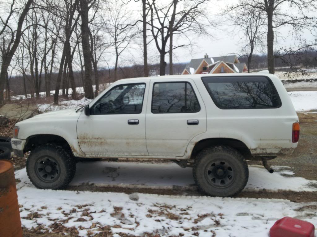

I got the white one from a friend. It is a stock 1994 3.0 with the R150F 5 speed trans and manual tcase shifter. Its got some decent 31" BFG ATs in the front and 31" BFG MTs in the rear. Blue interior is ok condition. Has 4.30 gears. My buddy recently did a timing belt and everything on it and a week later popped the head gasket. I think it is worth it to fix the headgasket in the car but there is a 92 sc400 parts car not far from me and that 1uz looks pretty tempting. Also have a pro comp stage 2 lift kit from my pickup that I bought used but never installed. I'm going to put the front on and get a lift for the rear, sell the 4" leaf springs.

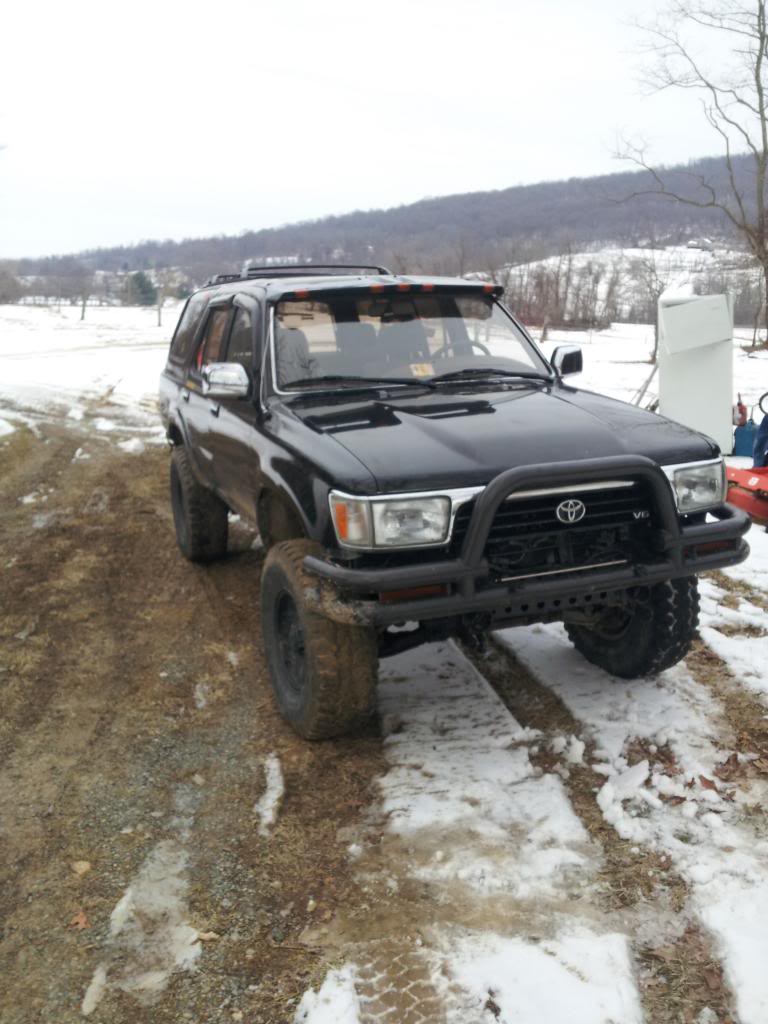

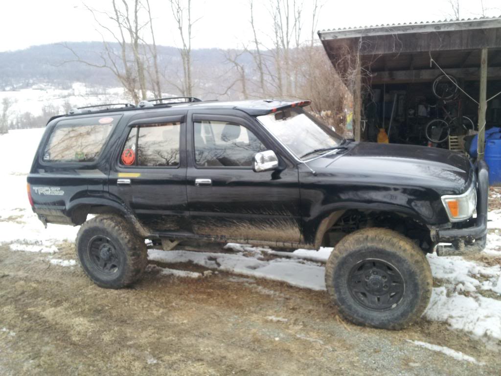

The black one I picked up off of craigslist. It's a 94 too and has the G144 axle code so that means 4.88s!! The tan interior is a little nicer but no engine and it has the a340h auto trans. Smittybilt front bumper. Rear air deflector for the rear window.
My plan is to swap the interiors and a bunch of other parts and put the 4.88's in the white one. White one will end up being a DD weekend warrior type thing. Not really interested in crawling but more trails and stuff. Shoot, the roads where I live are pretty much like a trail with all those damn potholes. The black one might be going to a buddy of mine after I'm done taking what i want from it.

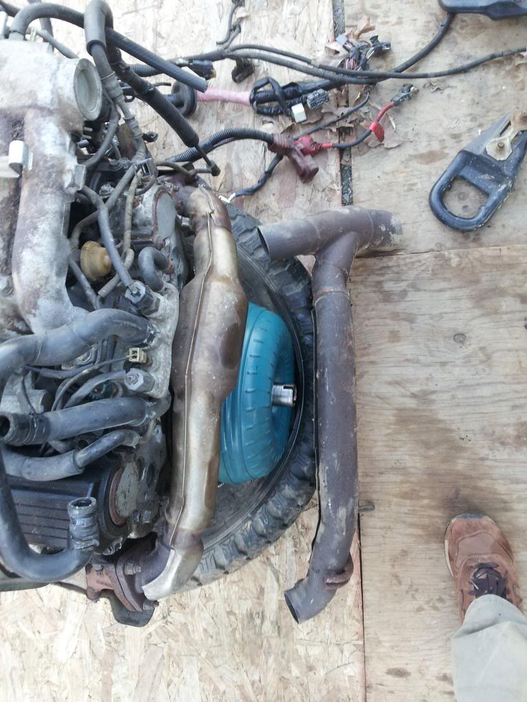

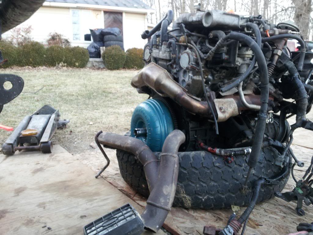

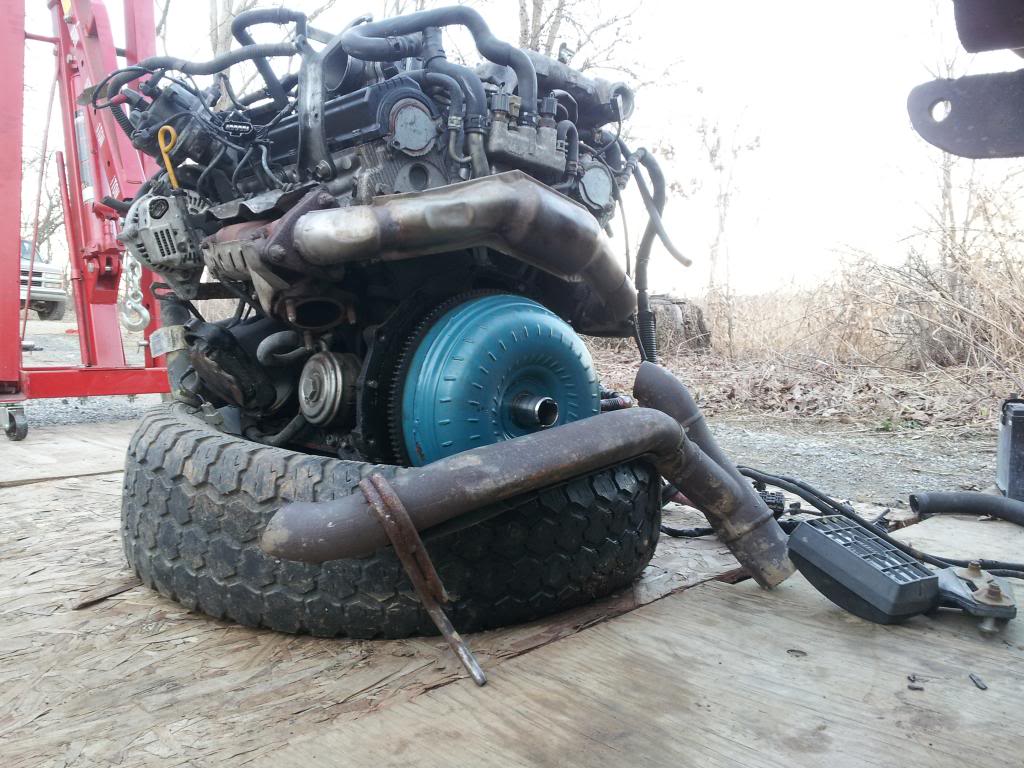

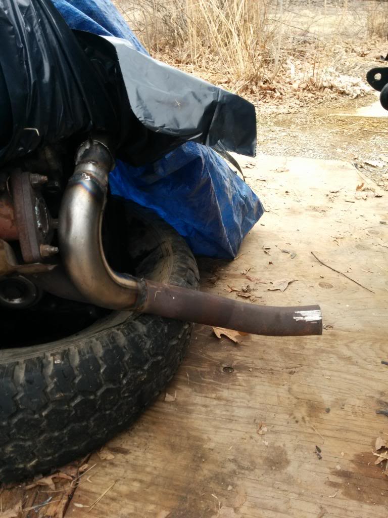

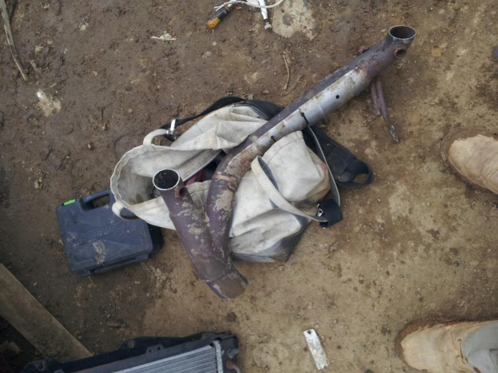

Ended up getting a good running engine for cheap and it's going in the black runner. Before it goes in I want to do the crossover elimination mod. I found this Y-pipe at the junkyard today and I might end up using this.. It would be almost perfect if I re-route the exhaust on the passengers side and crossover underneath somewhere but it looks a little tight and I may have to relocate the trans cooler. Or I might be able to cut and rotate the ends so I can get it out the drivers side. Can't do anything til my buddy gets argon for his welder so might be a few days. Here's a couple pics.. Also picked up a pair of heavy duty tow hooks from an Excursion that weigh 15 lbs a piecs almost, some cheap fogs and a radiator..

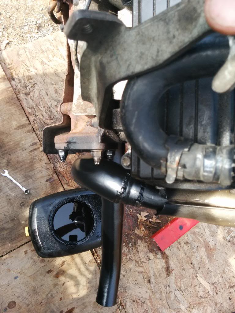

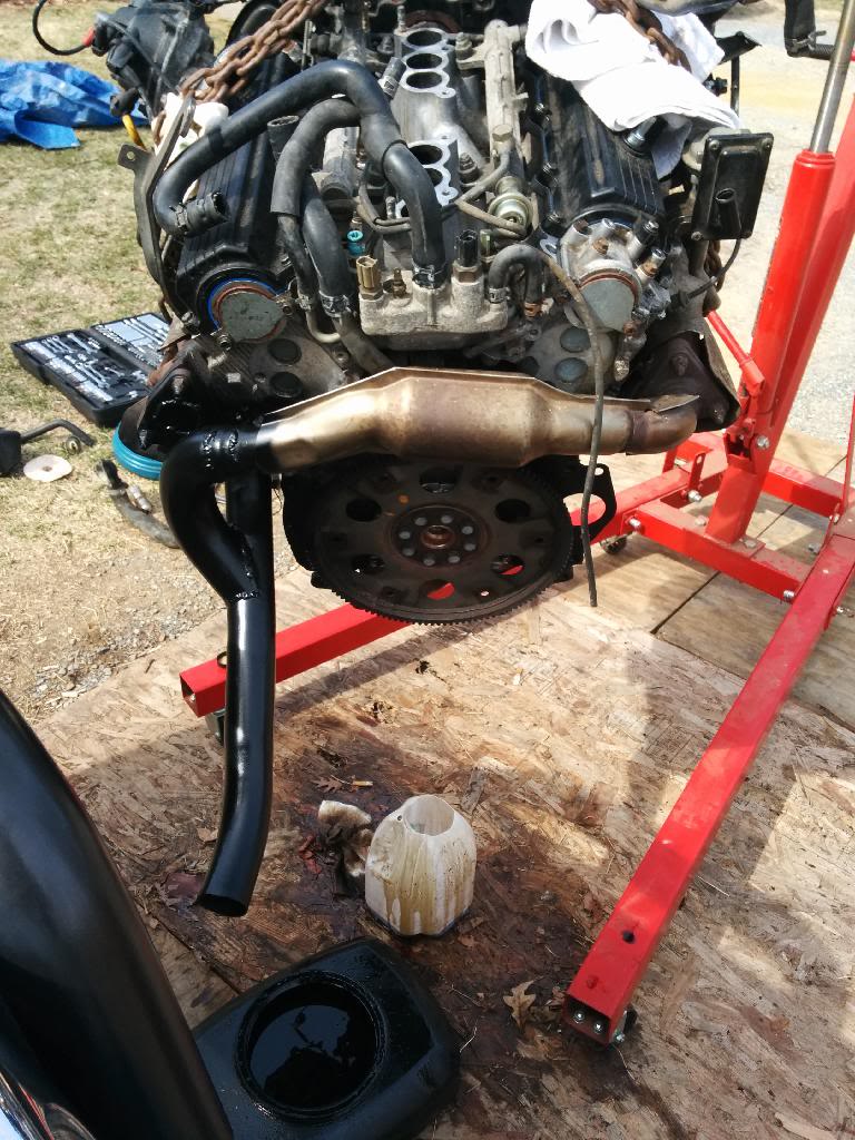

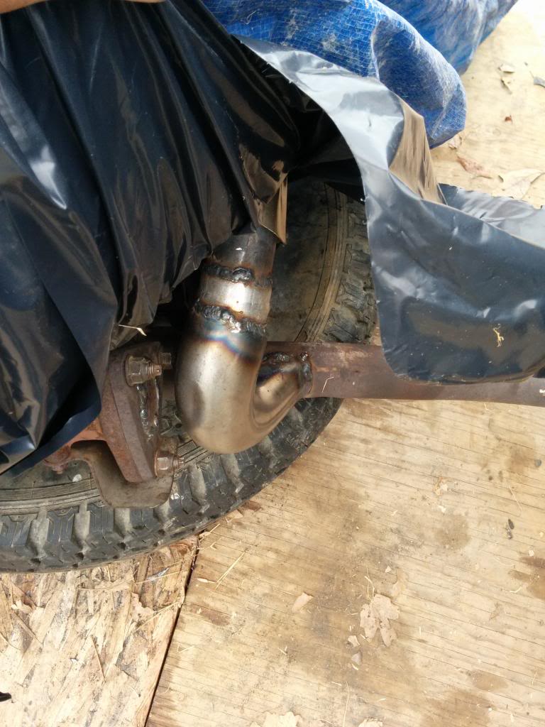

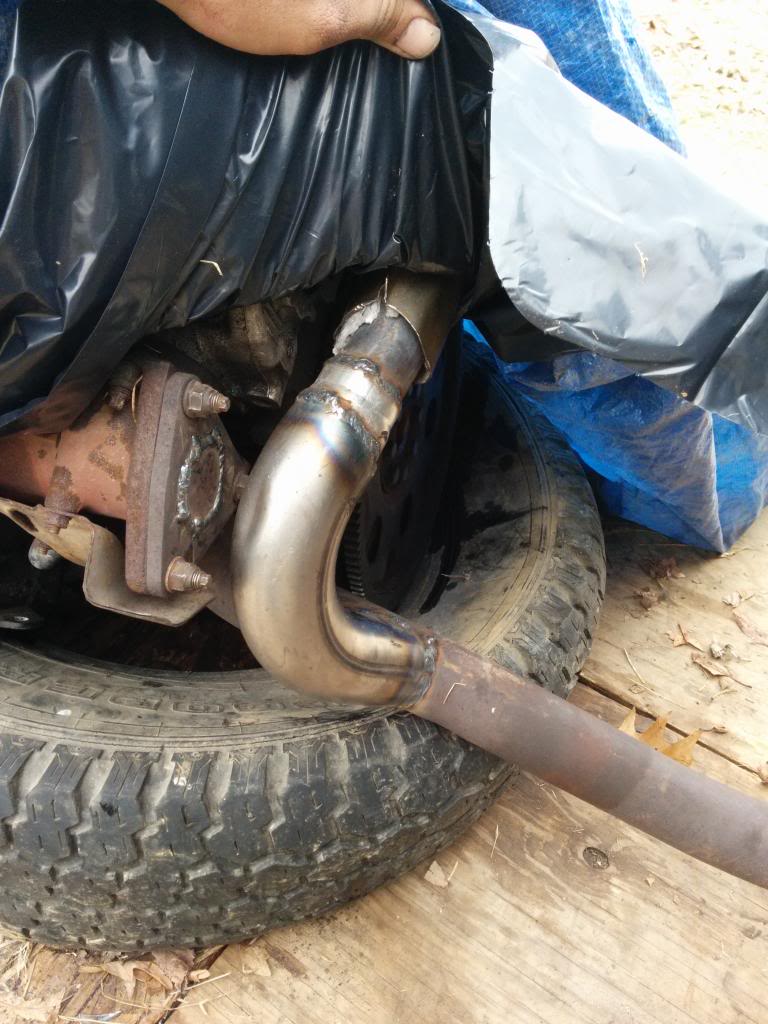

Crossover pipe mod is done. Ended up just cutting the flange off the drivers side manifold and making the crossover turn down at that point instead. I have another fully assembled 4runner here that we looked at to check clearances so it should hopefully not hit anything although getting it in might take some finesse sneaking it in.

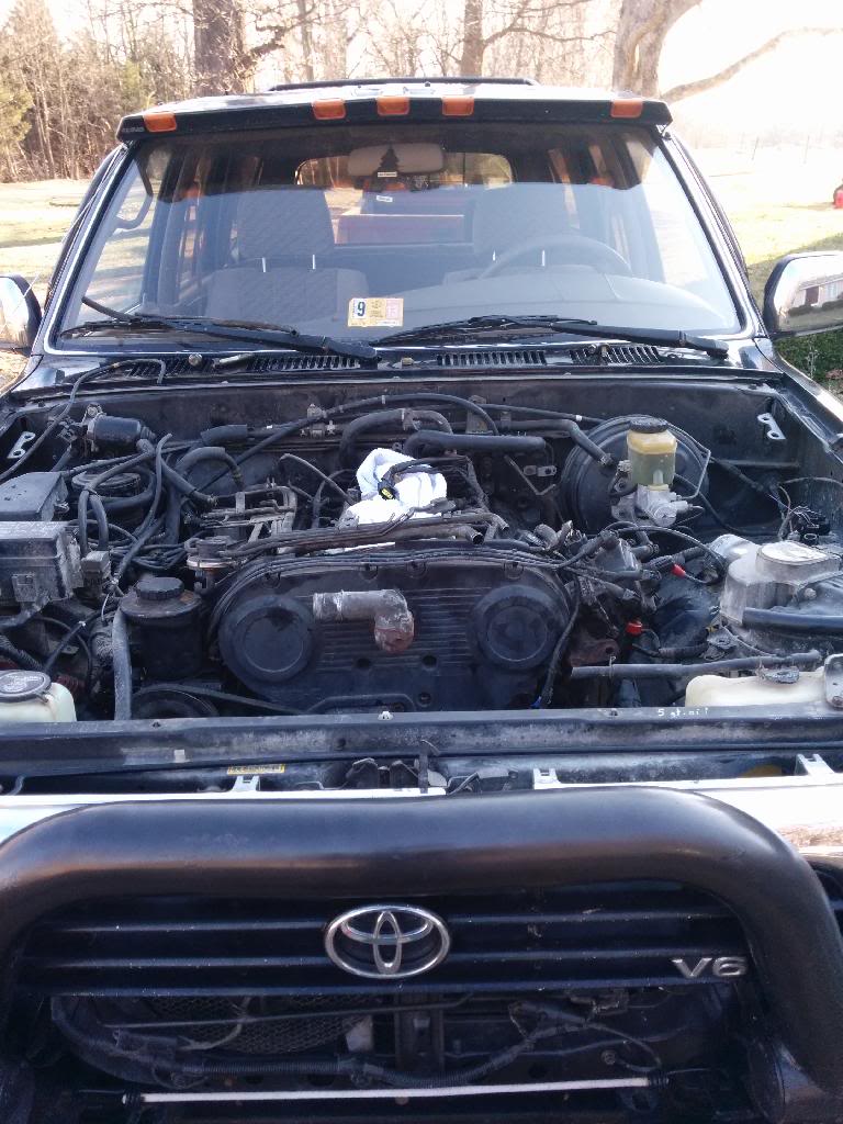

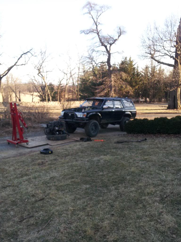

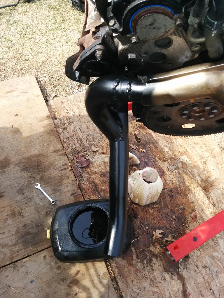

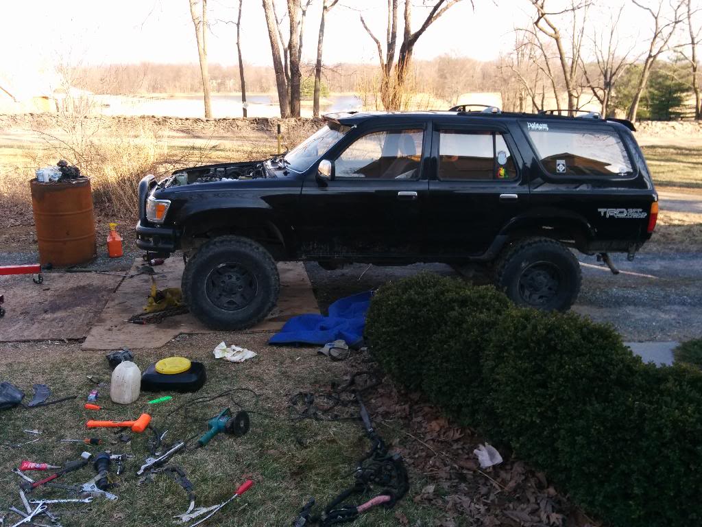

Yea I'd like to get yota headgaskets but the rock auto ones are appealing to the wallet. Here's some more pics of the crossover. Sprayed it with 1200* Krylon grill paint. I just got the engine in today and there were ZERO clearance issues minus having to bend a heat shield back an inch. If you have the heater lines that go back for the rear heat controls it might pose a small issue but this one doesn't have that. I was skeptical of this engine but I think it is gonna be fine. There is very minor surface rust on the cams and its coming right off with my finger nail.

I'm confused by the exhaust work you did. Isn't the purpose of headers and the like to remove the crossover thereby reducing HG failures?
Old Mar 22, 2014 | 05:47 PM
lostmenoggin's Avatar
Joined: Feb 2014
Posts: 45
It's the way it crosses over. Previously all the exhaust from the passengers side manifold had to go past the cylinder #6 exhaust port on the drivers side before it hit the downpipe which some assume is why there are HG problems. Exhaust inefficiency. The bulge in the crossover is just a flex pipe not a pre-cat or anything so theres no hold up there. Now it flows much more freely and merges more naturally.
Old Mar 22, 2014 | 06:42 PM
Just_ Rollin''s Avatar
Joined: Apr 2013
Posts: 101
From: Pennsylvania, East
Oh I see. I can't justify $600 for headers and I can't weld, so I guess I'm stuck with my fingers crossed that the HG doesn't go at some point with my stock header. I like what you did.
Old Mar 22, 2014 | 07:15 PM
Joined: Feb 2014
Posts: 45
Thanks Im happy with it. Yea man headers are super expensive. I cant weld either I paid a friend of mine to come out and weld it up lol.
