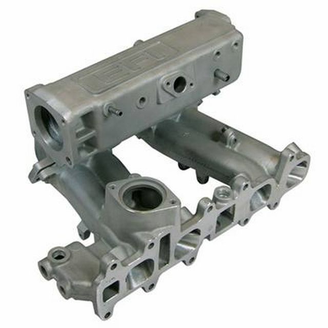

Check around your thermostat housing on the intake. The first two intake ports ( cyl 1 and 2 ) are right next to the thermostat housing. The intake gasket could be pinched or the surfaces of the intake or head could be warped.

thanks for the reply the head actually was warped but i had it machined so i figure it should be fine and i did try taking off the intake today and the gasket looked fine still but i went ahead and put some rtv around it too like i had read on another thread, havent gotten it back together yet hope it fixes the problem but im not too optimistic just because the intake gasket looked fine when i took it off

thanks for the info everybody the problem did end up being the intake gasket not sealing well enough hard to believe because it looked fine and not pinched anywhere when i took off the intake but anyways to anyone in the future doing a headgasket or just intake period i would def put some rtv along with the gasket just to be safe
