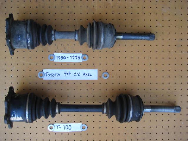

in the grand slam kit, they advertise t-100 cv's. any particular reason? are they longer than 4runner and hilux cv's. do they somehow seem to hold up better with a small lift? or perhaps there is no reason at all.
Old 08-10-2010, 10:54 PM
BlazeN8's Avatar
Join Date: Jun 2009
Location: Southern California
Posts: 977
Received 4 Likes on 4 Posts
The T-100 CVs have a longer inner shaft (about 3" longer) but otherwise they share the same components as the 4 Runner and Hilux. The extra length is there to accomodate the longer control arms. Yeah I know, I misspelled axle!

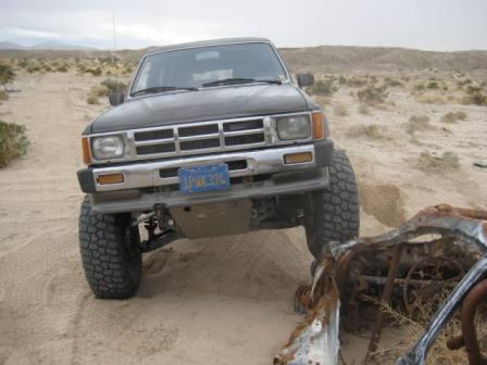

I got's me a sweet 4" Drop Bracket / Blazeland Long Arm Combo Kit now! Installed it on my 1986 4 Runner. Its set up as a pre-runner for now.

oh common Nate, you have to post more pics than that

Nice! That's what I want to do next!

Just out of curiousity. How about the idler arm. Do you bracket/brace it or is there alternatives?
