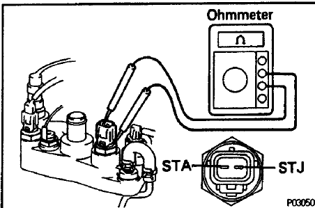

Cold Start Injector Time Switch
If it is right next to the bypass hose, it is the "Cold Start Injector Time Switch"

Thanks Bob, I took your image and determined it was the one I highlighted in red.
Hey 92, I hope there's only one leak lol I had to take my little Canon elph and stuck my hand back there and took multiple photos this thing was bubbling and spraying on the fire wall down on the exhaust and had a little Coolant pooling around its little rim/lip edge? I thought it was going to be the little heater tube that everyone mentions but that things was high and dry.

That is the "Cold Start Injection Switch". It has a metal gasket between it and the hole. The bad news is the easiest way to get to this is to remove the plenum. A new plenum gasket is under $10, but it will take a few hours to remove and replace. Don't forget to take pictures of all your vacuum hoses locations, and maybe even replace the PVC valve while you have the plenum off! Immediately next to this switch is a vacuum switch for the evap system. If you touch this switch the wrong way, it will snap off one of the vacuum outlets, and you will end up replacing it as well. ($30) Be careful. Once you get the plenum off, there are only (2) 10mm's nuts holding the pod on. You will need high temp gasket maker when you put the pod back on.
