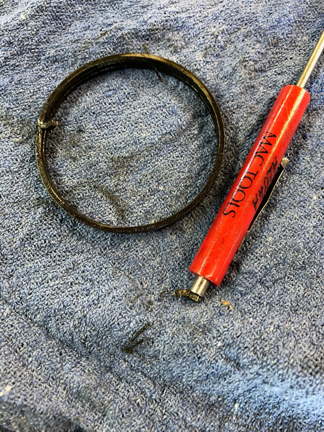

loosen the six hub mounting bolts. solid tap the studs using a drift and hammer, until the cone washers visibly begin to slide outwards. remove locking hub assembly. inspect the insides of locking hub assembly that you just removed. is there a piece of metal all twisted up in the outer cavity?
Okay, so it sounds like they found a broken spring inside -- anyone know where to get replacement springs? Or since people seem to hate these hubs (that I like), care to send me your old spring?
