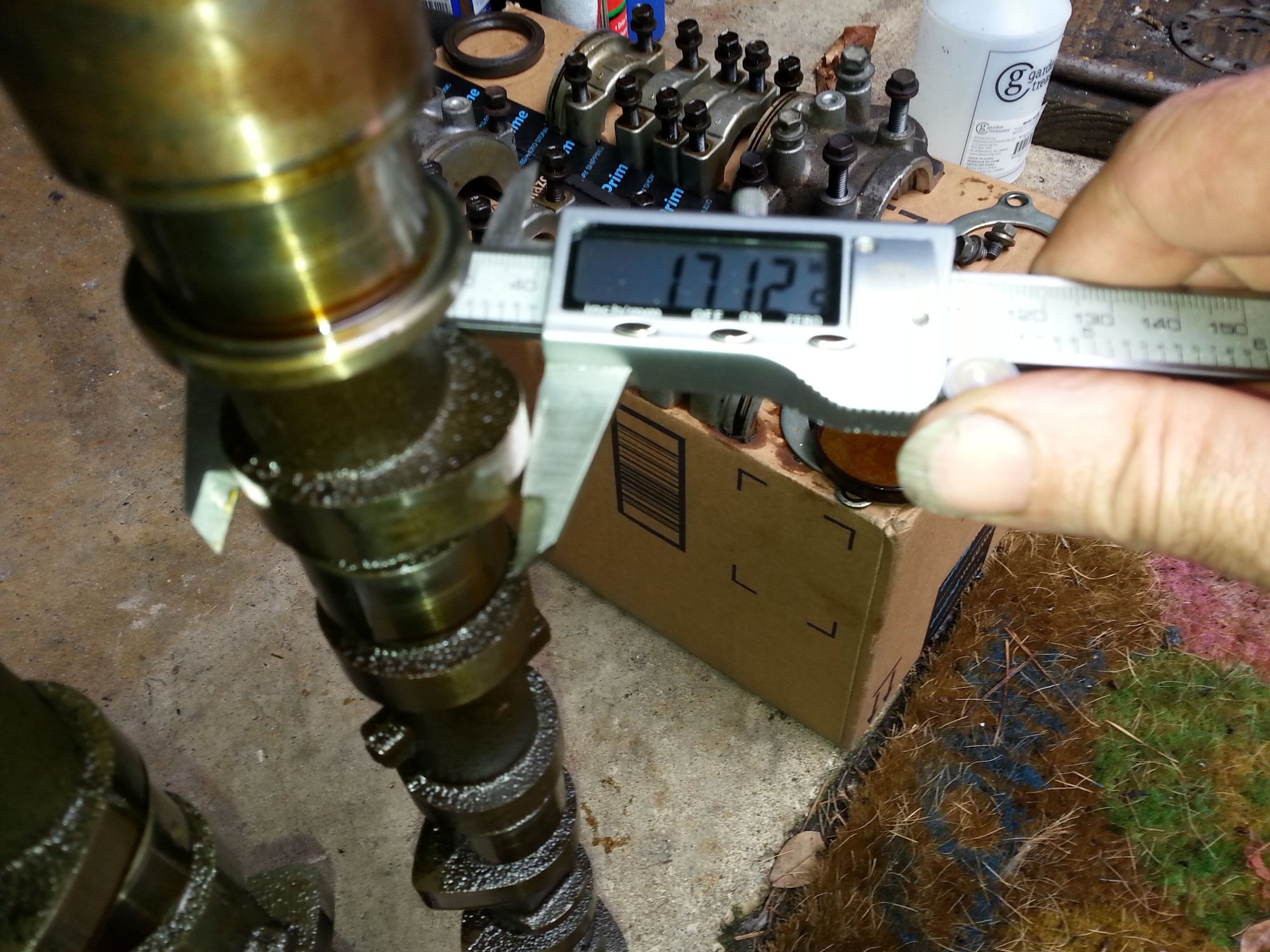

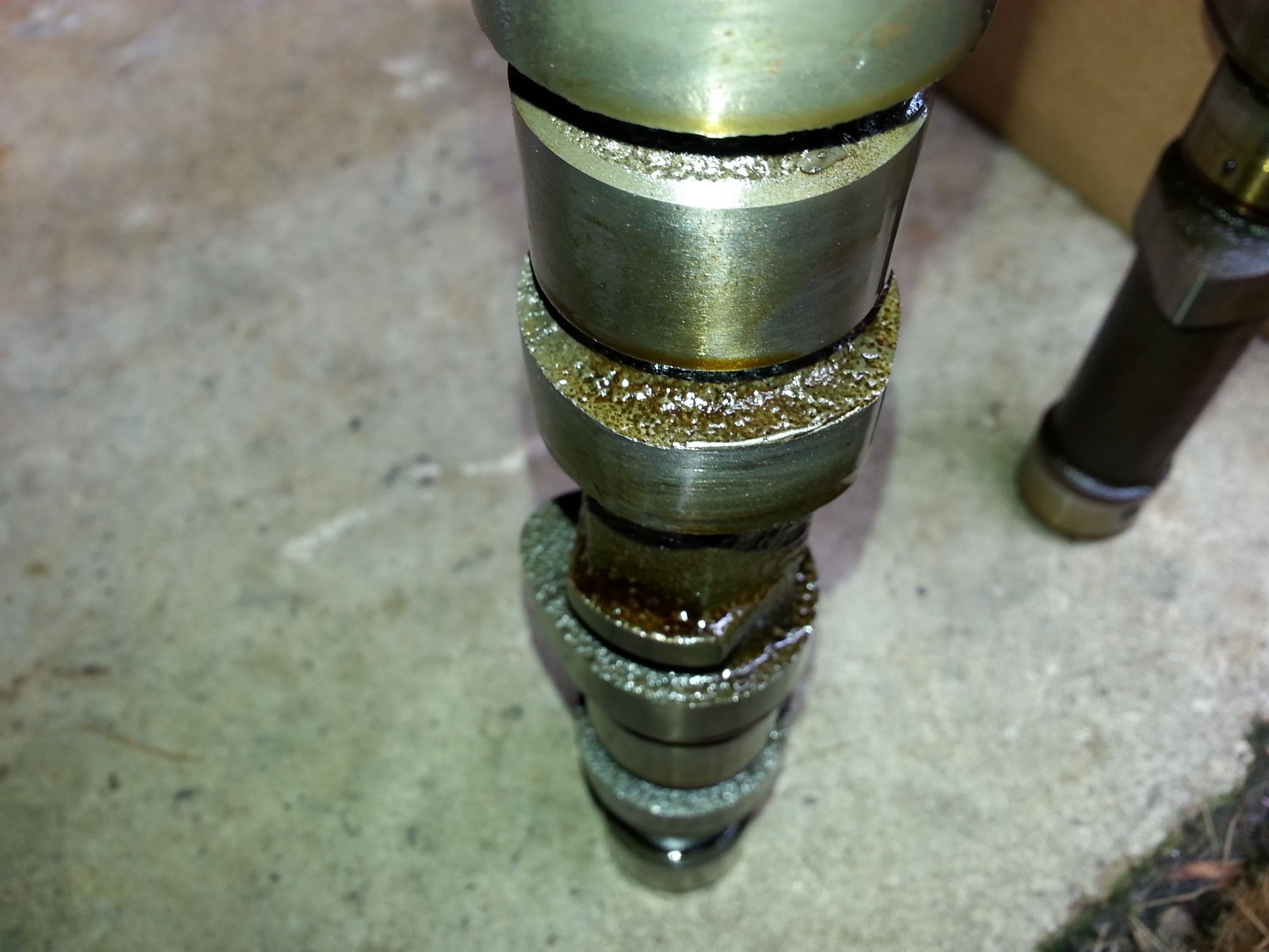

As someone else mentioned reminds me of my old mustang days when people would change from a regular hydraulic cam to a roller cam and not change the distributor gear. Definitely think non OEM camshafts can have problems. My experience with a set was less than optimal. 2 lobes worn severely and 1 lobe totally gone.
