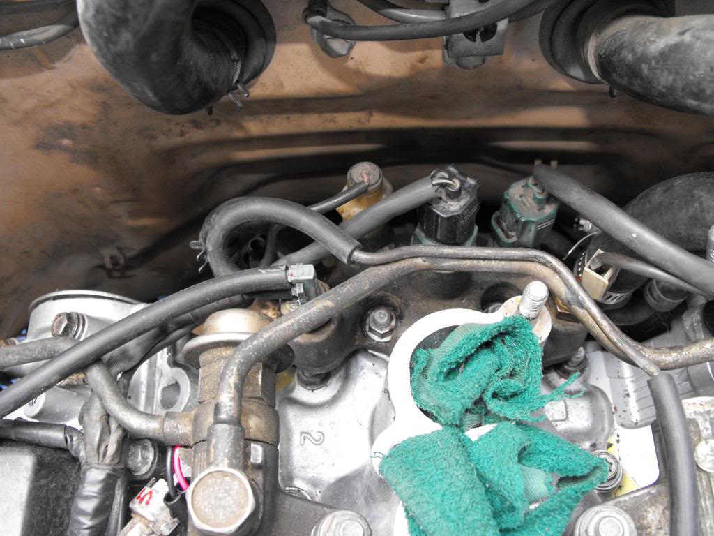

Seems I'm a plug short.
I have 4 plugs that led to the rear of the motor.
Old Jul 25, 2013 | 09:20 AM
big bear's Avatar
Joined: Jul 2013
Posts: 294
From: Big Bear Lake, Cali
As you can see there are only two plugs(each side) coming out of the harness that runs along the top of the engine.
I've looked around pretty well for another plug in the motor bay.
Old Jul 25, 2013 | 09:24 AM
big bear's Avatar
Joined: Jul 2013
Posts: 294
Unfortunately my dis-assembly pics don't show the knock sensor wire.
These are fresh pics of re-assembly.

Ok, I think I routed the pig tail from the sensor the wrong way, I have the pig tail going out from the back of the intake manifold(lower) just above the crossover pipe.
Looks like I need to pull the manifold and re-route that piggy.

Yep, I routed the wire the wrong way.
Pulled the intake manifold off, re-routed the pig tail.
Problem solved.
