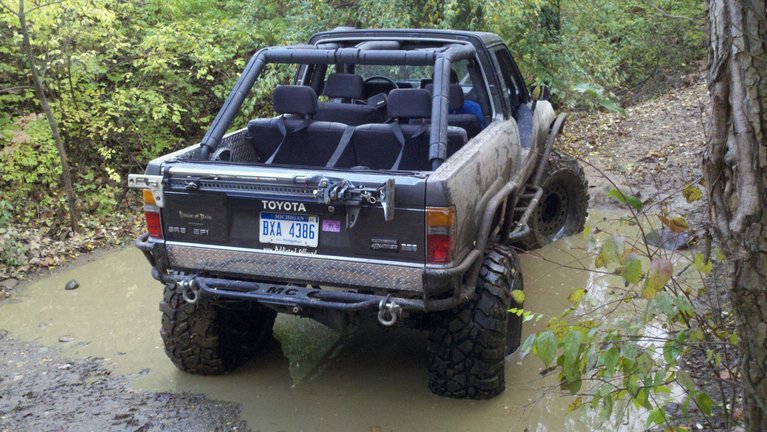

I BEAT my 22re like I stole it on a regular basis! It is a 86 4runner and has 280000 miles on it and has never let me down. As the previous posts have said , if you take care of the head gasket issues and the timing chain these engines will go for a long time. This is my runner ,so you can imagine the stress on the engine

Glad to hear another success story with the 22re, stereoguy!!
Nice truck BTW! I used to have a cj7 built up kinda like your yota. Man that thing would go places you didnt want it to. He he. Im sure your yota does too!
