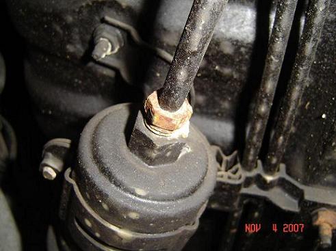

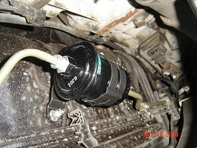

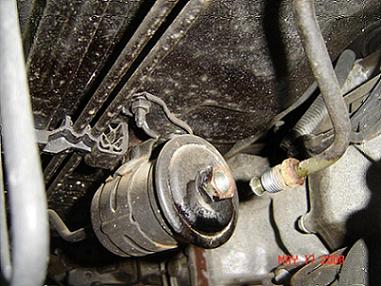

Just finished changing the fuel filter AND fuel lines-front and rear-on mine (3rd gen 4Runner, 87k). I used a 14mm open end wrench on the fitting, an adjustable wrench on the filter bolt ends (probably a 19mm, lucked out with only an 18mm in my arsenal), and used a 10mm deep socket to get to the bracket bolts that held the filter to the frame.
Yes it is a PITA - I spent at least 4 hrs alone on one rusted fitting towards the rear fuel line/gas tank, used up nearly 3/4 can of CRC Freeze-Off and all my energy of youth. I wanted to change the lines in addition to the filter because they were especially rusted. I was able to squeeze the box-end of the 14mm thru the rear fuel line all the way to the fitting (after unbolting the fitting between the rear line and filter) and that saved me from rounding off the corners. Fuel lines are a biatch. Rusted fittings are even more. Had I rounded off too many corners, I'd have no TOY to drive to work
I have yet to drive it, but the successful cranking and startup gave me a feeling I cannot describe for someone who never attempted the fuel filter and came close to screwing up his only means of transportation.
Costs: $33 fuel filter, lines $19 rear, $35 front, labor $0 bought from the dealership
Labor: several hours!!
...But definitely worth it all Enjoy the pics!
