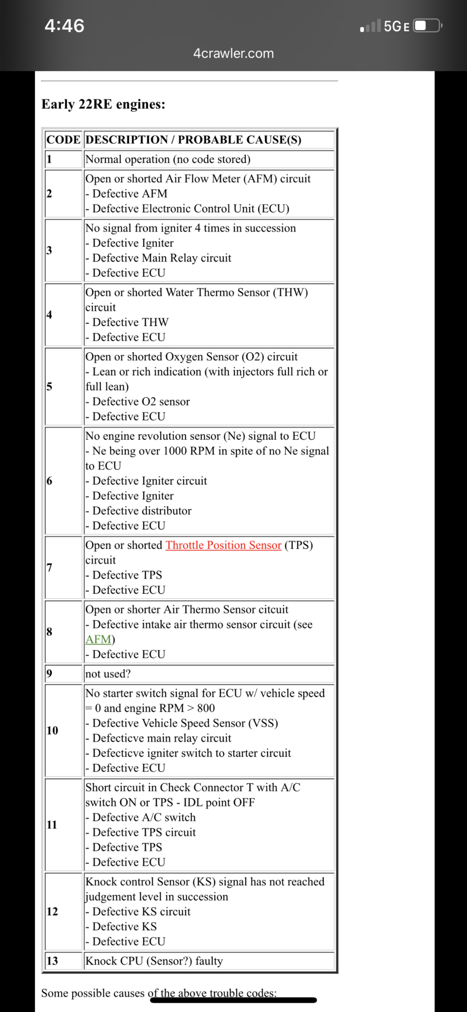

Forgot to mention. Checked codes as well, got a code 6. Swapped dizzy pickup since the old one looked rough, and the wires were hard as a rock. Changed plugs and wires as well. No difference

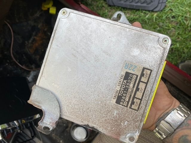

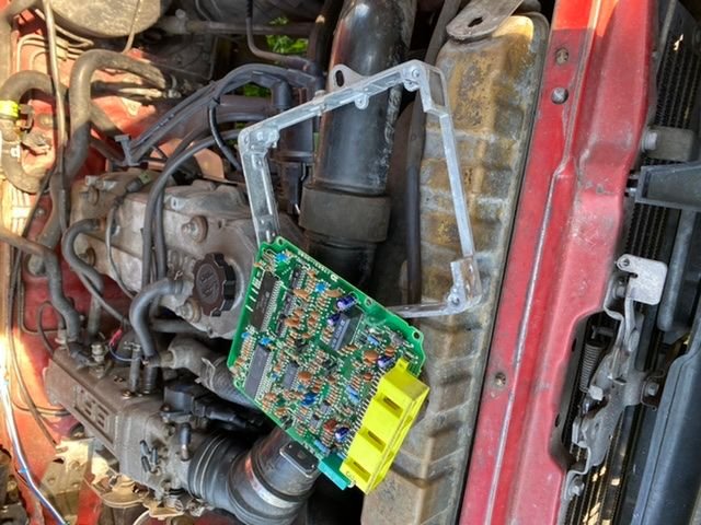

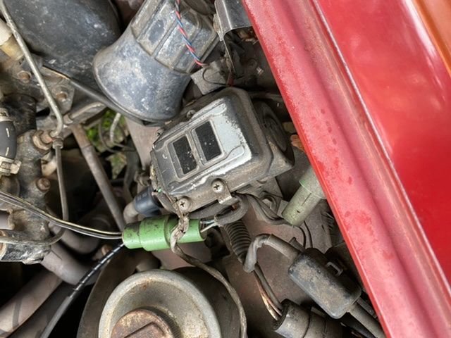

This is the ignitor, correct? Is this an ecm/ecu? Or is that a separate unit somewhere? Is there any other computers somewhere?

ok, so ill guess this is the ecu. Looks ok, nothing visibly burned up or out of the ordinary. Cleaned it up, reassembled, reinstalled.

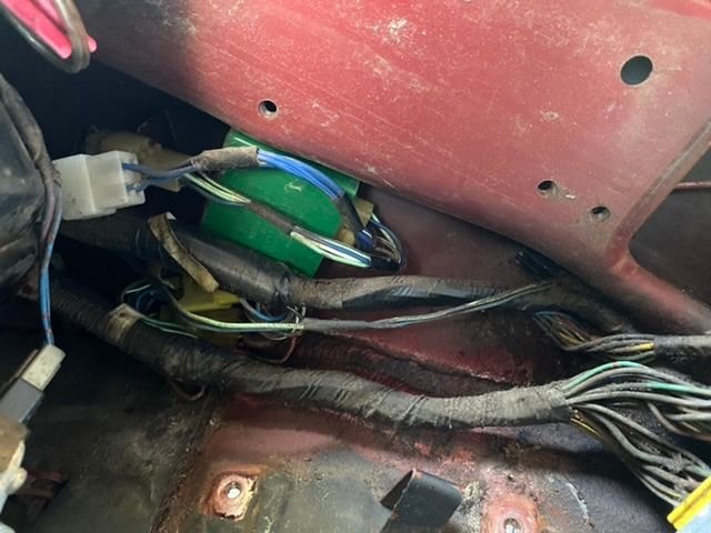

Whats this green guy behind it? Passenger side in front of door

I think the green box is for delay wipers.

My DLX has wiper delay but des not have that green module. I think green box is Light reminder relay.
