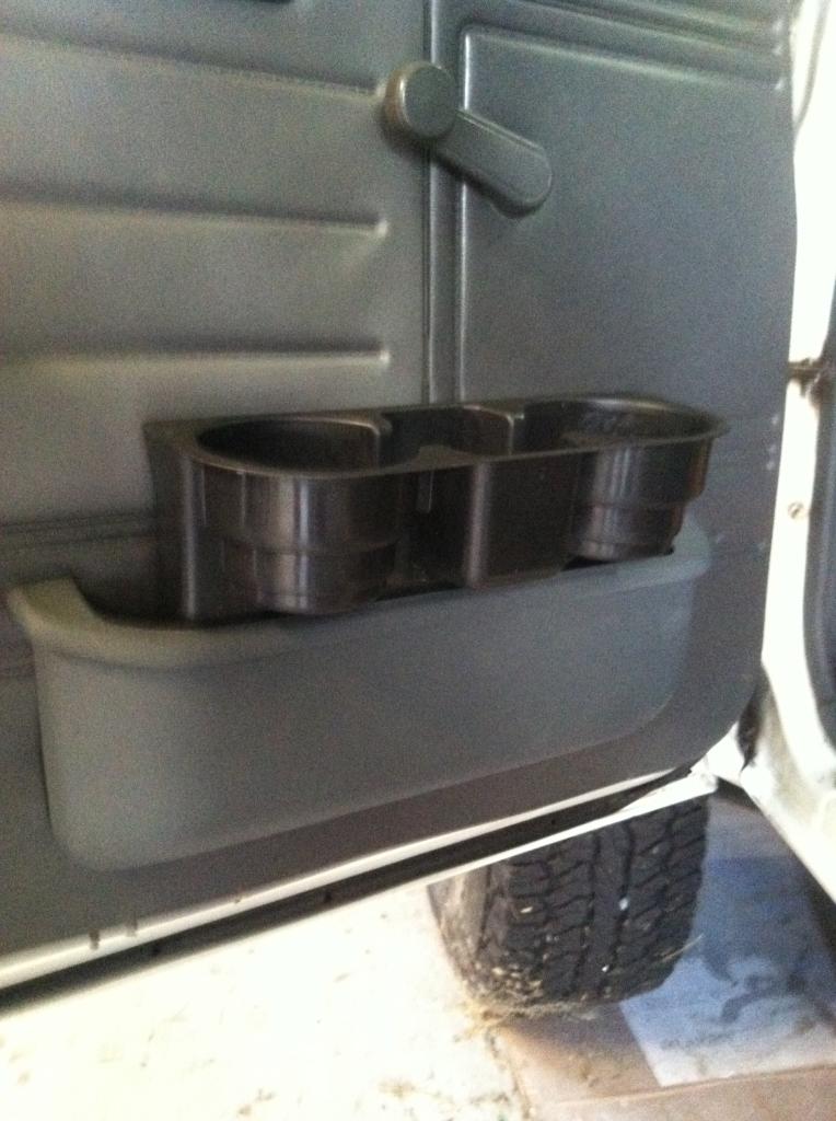

What's your objective? To find a paint code or find matching paint? Terry87 once took plastic trim to an O'Reilly's that will match paint and put it in a spray can. It was about $25 a can. His interior was red. I've been using Duplicolor plastic and vinyl paint from Autozone and Advance Auto. I used the darker gray here. If you need the exact color let me know and I'll go look at the can out in the garage. The door pockets below were red. In person the paint seems exact, In the picture it's a little off. I've also painted an ashtray that looks perfect compared to the dash.

I have done several interior pieces. Even in Nervo19's picture you can see the two different tones of gray Toyota uses. From a previous experience, I helped a member on the west coast and Oreilly and Autozone in not allowed to mix paint at their stores. California will not allow it and I think it applies to Washington and Oregon but could be wrong on those two states. As far as I know any other state the stores can mix interior paint. It has to be especially made for interiors.
