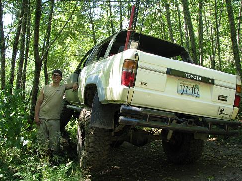

pull your rear third out, take it to your local fab shop, have them pull the carrier and weld the spider gears. Bingo Full time lock in the rear for 1-2 hours of shop cost or if your lucky like me and live near Brashears offroad and get ur done for 30 bucks.
Best upgrade so far!!!
