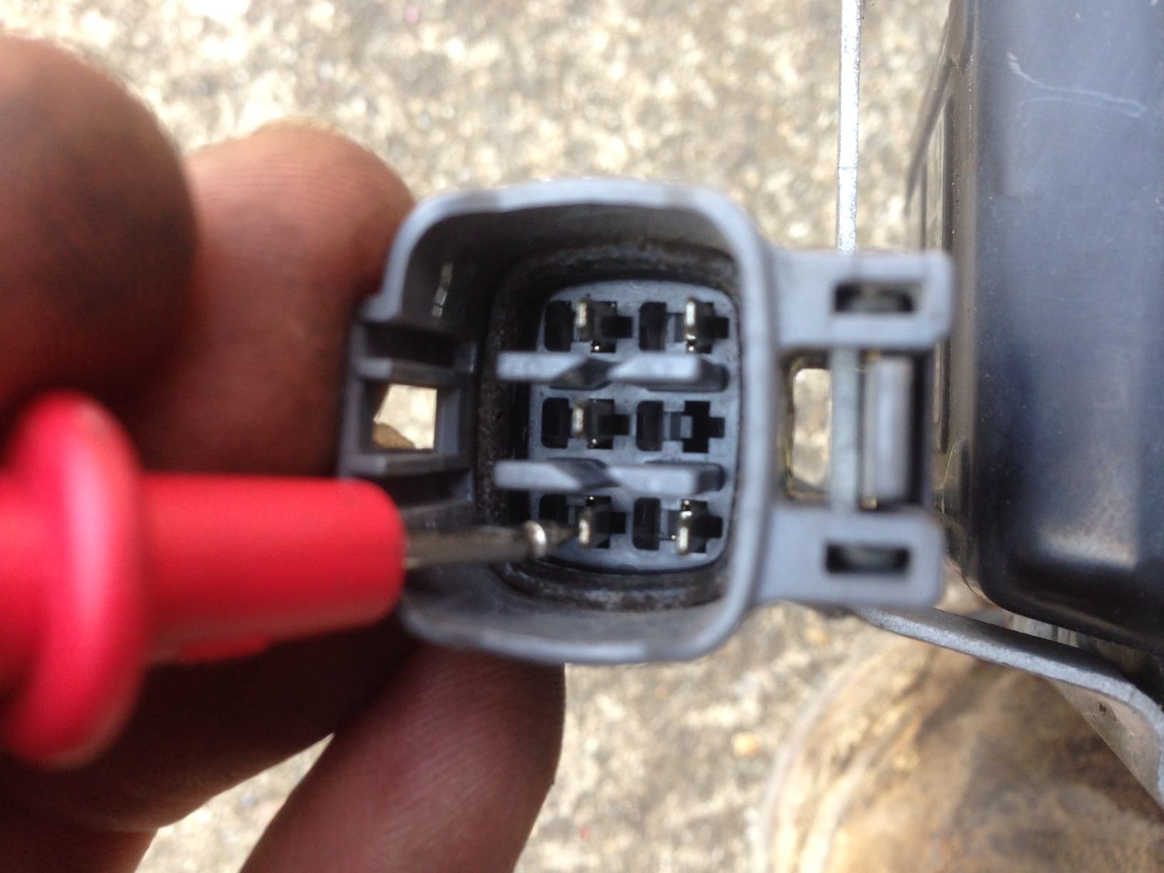

my test probe is pointing at the pin on the igniter plug that had continuity with the negative lug on the coil. I believe this is where the tach signal comes out of the igniter
here my test probe points to the pin for the tach signal wire (this plug goes into the back of the cluster)
