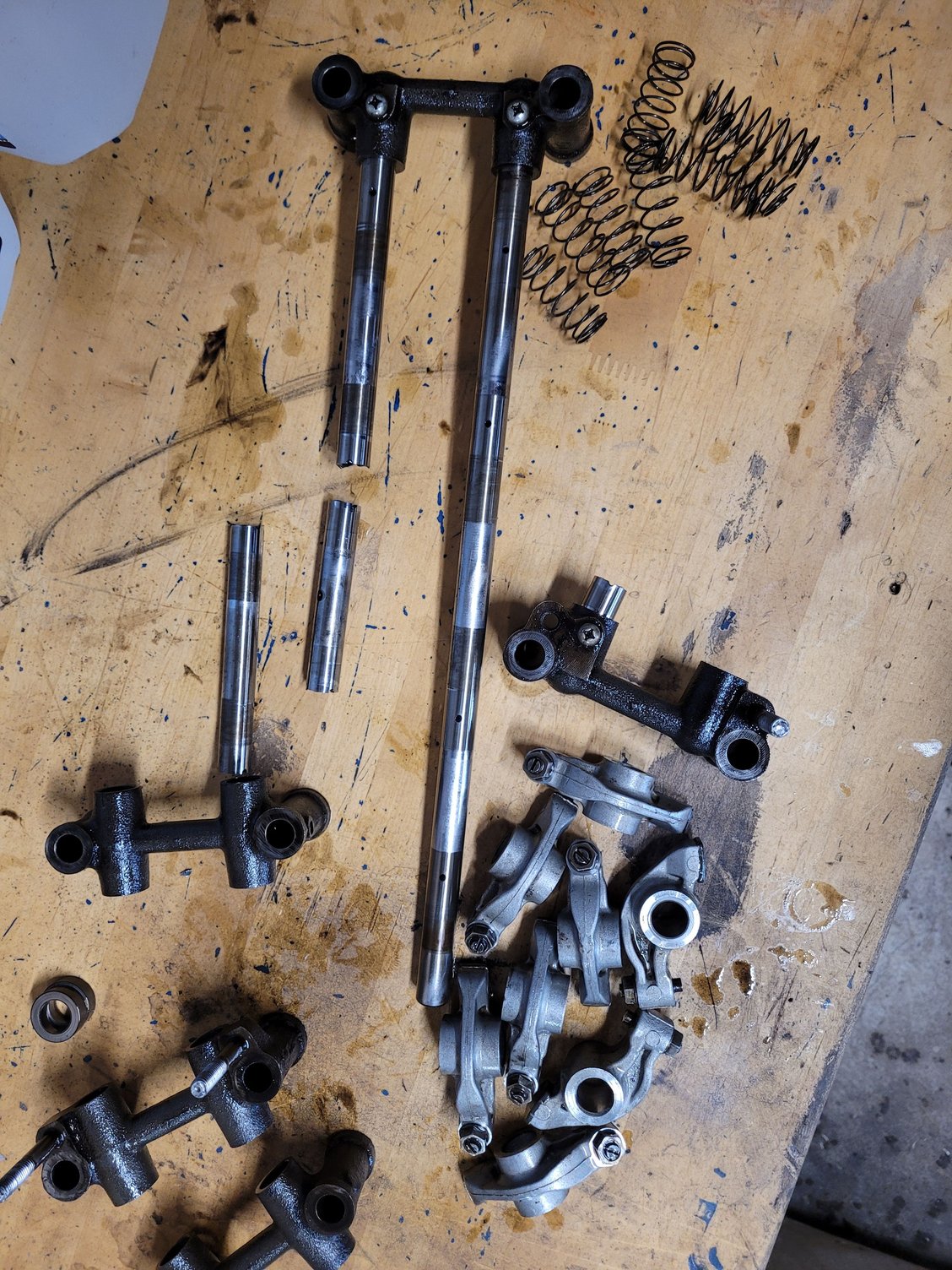

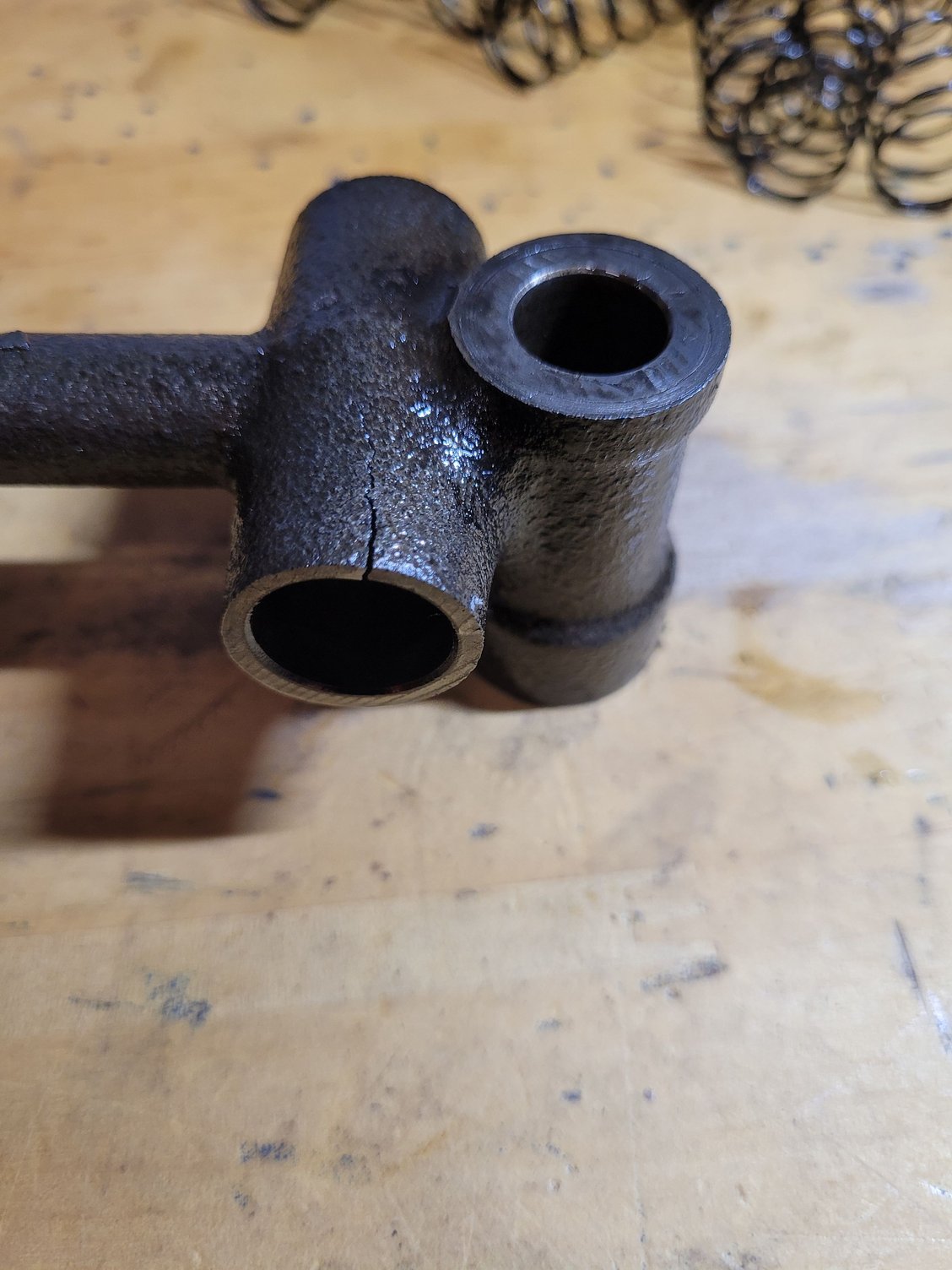

Found my problem...
Warped head? Head gasket isn't leaking...
So pissed!

Old Jul 1, 2023 | 06:48 AM
Jimkola's Avatar
YT Community Team
5 Year Member
Joined: Jan 2020
Posts: 2,253
Likes: 1,003
Yikes! Well, that’s a new one for me.
if you get a used rocker assembly off a 1990-1995 22R# it should have the updated rocker arms with better oiling.
I’d put a new headgasket on at the same time, and take a good look at the chain guides. But that’s your call.

Thanks Jim, I'll check out your post on the TPS. I think I know what I did wrong. I didn't pack or prime the oil pump and didn't turn the engine over with the coil disconnected to build oil pressure before starting it. Likely didn't have enough oil moving to the top of the head and just overheated the rocker arm assembly. Hopefully I didn't fry the valve or warp the head. Stupid costly mistake that I won't do again. Live and learn.

I don't think you caused it. 22R#'s are very good about turning black and blue when lack of oil is an issue. The oil pump would start moving oil very quickly, well before a failure like that.
A few possibilities leap to mind.
1) Let's say the prior owner blew a headgasket. head was warped, and they machined it. Now, you can make the mating surface flat again by machining, but the top is still warped. The big flaw in this theory though, is usually the camshaft breaks first. But worth taking some measurements off the head to see how much, if any, prior machining has been done.
2)the other possibility is someone thought torque wrenches were a marketing scheme and relied on calibrated brute strength when tightening down the head bolts. That might explain the broken shaft and the tower cracking.

Believe it or not, I have a complete rocker assembly on my shelf. I've looked it over trying to make sense of that crack in the tower and broken rocker shaft, and I've got nothin'. i thought maybe the broken tower might have gotten assembled pointing the wrong way, but I can just make out the arrow in your first photo and it looks like it was pointed the right way. My gut feeling is someone made a mistake during assembly, as that's not a typical failure. The other possibility is the head is aftermarket; and has casting issues. But these are just guesses

It's been a while. A looooooong while but I finally sorted some important things out. After finding the rocker arm assembly shattered I pulled the thing. When I had the head resurfaced they found a burned valve on the intake side. Hence the loss of power. She's all back together now with lots of new parts and she ran great! Now I just have to keep my fingers crossed that she'll pass smog...🙄 Thanks to all for suggestions and encouragement. It was a steep learning curve but I think I'm there for now. Haha!

Hey Jim, turns out the person before me put one of the head bolt pins in incorrectly. It had a bur on it from what looks like a heavy hand trying to set it with a drift pin. In turn when they put the head bolt in they had to pound it in with a hammer. Had a gouge all the way down the threads... Once again proving that brute force is not always the answer. I'll post pictures soon.
