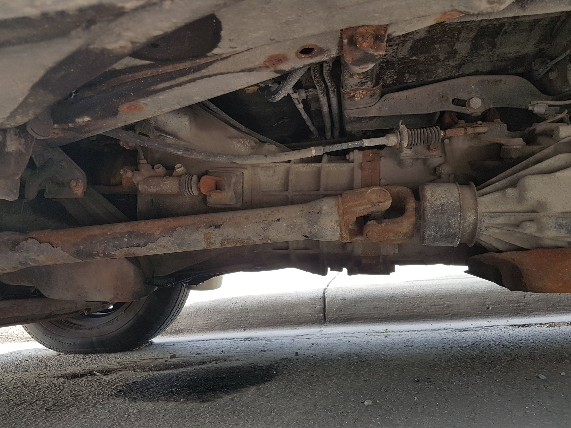

How much weaker do you figure? With a stock tune the alh is similar in power to the 3L but yes it does have more torque. The 3L has about 136 ftlbs torque Co pared the the alh 159 ftlbs, would that small of an increase in torque be enough to grenade the trans? I honestly have no idea. But the weird thing about the hiace is that there is no crossmember on the transmission : it just has one hanger on top of it holding it in place so mounting up an r150 would be a huge challenge
It's hard to see but there's an engine mount thing on top of the trans

Those two torque ratings are similar enough that your tranny should hold up if it is sound.
You'll hardly ever be flogging it for all it's worth, right???
