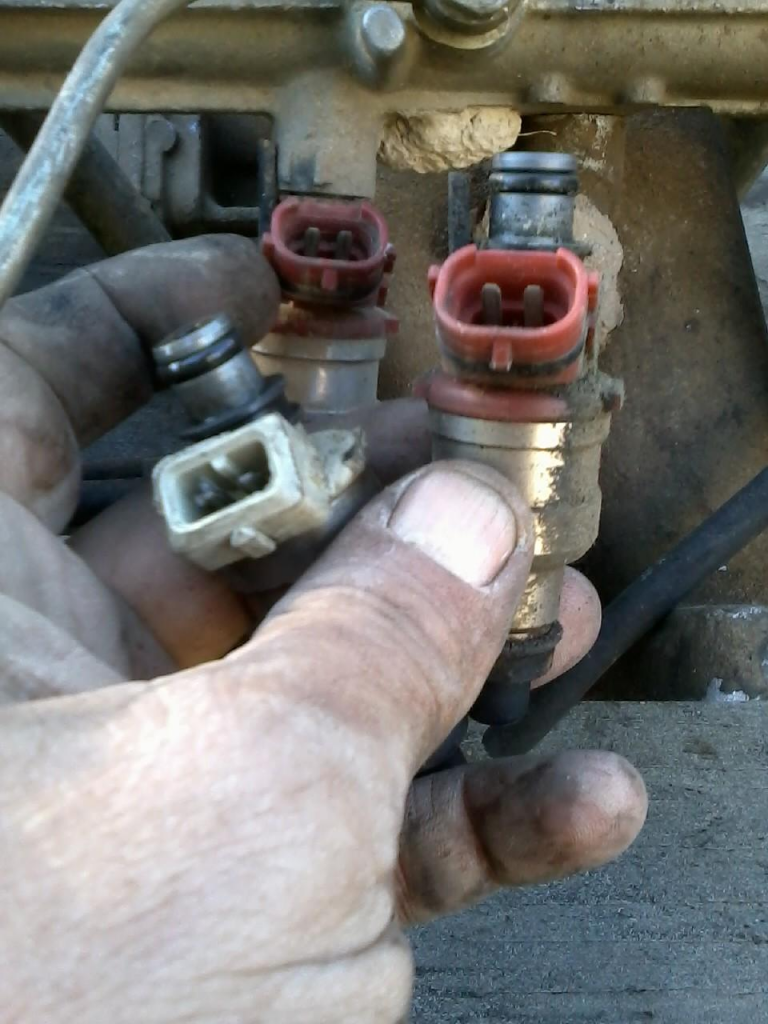

In your signature I see you have an 87 Runner so that is what I am assuming. I may be wrong on the 90 and newer model as I have not worked on them in a while. Below is the different styles of injectors. The red ones look the same but the tabs are above or below the injector pins. I forget which is which but a resistance check will let you know which style you have. From looking at different harnesses and such, I am guessing the computer is designed to operate with the different resistance.
In theory the tabs should keep you from getting the two styles of red injectors into the wrong harness.
I have read in the past where someone has done the injector upgrade and if I recall right, they changed to the 89 and up. The clips on 87 and older is a poor design and get brittle. The newer connectors just use a squeeze tab. The newer injectors would be more available as well, but my luck I would try and ruin my computer. Never was brave enough to try something like that.
Copied...
Here are the 3 types of injectors. The white one is 85- 87, the 88 looks just like the 89 and up but the fool proof tabs are different. I dont remember which one is which but 85-87 is 1.5-3.0 Ohms, 88 is 1.0-2.5 Ohms, and the 89 and newer are 13.4-14.2 Ohms. Do a resistance check to see which ones you have.
