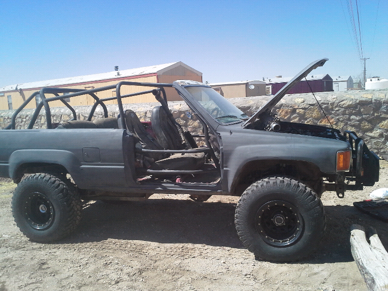

Okay first of all as I turn on my truck turns on perfect but as I give it gas it suddenly dies out completely could it be that my fuel system like my gas pump or injector aren't working properly? Or could it be that is has very low compression..
I just bought this truck

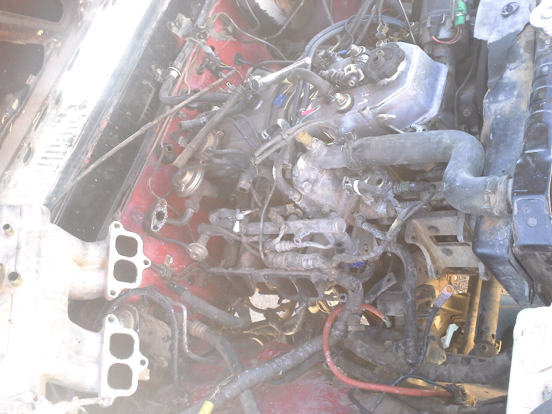

So I was replacing my fuel injectors the bottom rubber bushing that goes in got stuck. As I was looking at the injectors I see rust on them and really old looked like they have never been replaced it sad to see that my rig wasn't taken care by the previous owner. Im doing a full tune up to see if that's the problem causing my rig not getting its full power by doing the spark plugs, fuel filter, drained out the old gas (was sitting for about 6 months) also planning on putting a new gas pump (good thing I have one laying around) changing oil (thinking of using high mileage oil) oil filter, air filter and new spark plug wire. If Im missing something please let me know I basically have knowledge from working on Hondas all my life but new to the 4x4 scene so its a bit different bit loving it. Help wanted!-forumrunner_20130314_134120.png

If you think there is something wrong with the injectors, I would send them to witch hunter to have them refurbished and flow balanced. I believe it is about $20.00 per injector, and they can get them back to you within a couple days.
