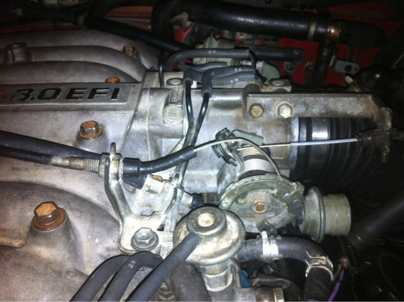

I'm gonna drop the pan first and see what's going on in there, also there seems to be no spring pressure on the cable at all.
If I fully open the throttle then let back off the cable bunches up in a U shape and I have to push it back inside the tube
Attached Thumbnails Help!! Trasmission problems e340h-image-1441533591.jpg   Help!! Trasmission problems e340h-image-2830115915.jpg

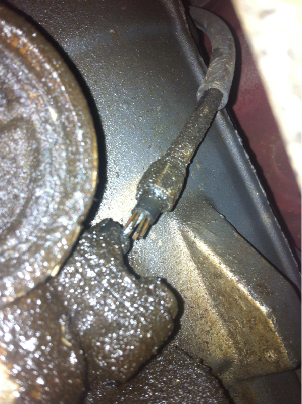

Here's a pic of where the kickdown cable gos in the tranny

UPDATE: removed pan, cleaned trans filter, reinstalled pan with new gasket and flushed with new fluid throughly, fixed kickdown cable...
So trans pull fine now but there is fluid leaking from what seems to be the little slit on the bottom of the bell housing, I do not know why it would do this...
