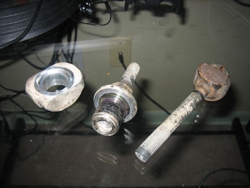

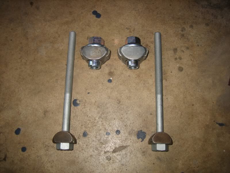

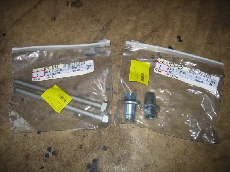

and I'd highly suggest just getting some new adjuster bolts and nuts from the dealership before you even try to turn them. I thought mine were in good shap when I went to losen them to swap upper control arms, but as soon as I put a decent amount of torque on them, SNAP!!!
I think it was like $16 from the dealership, and I was all good to go again
