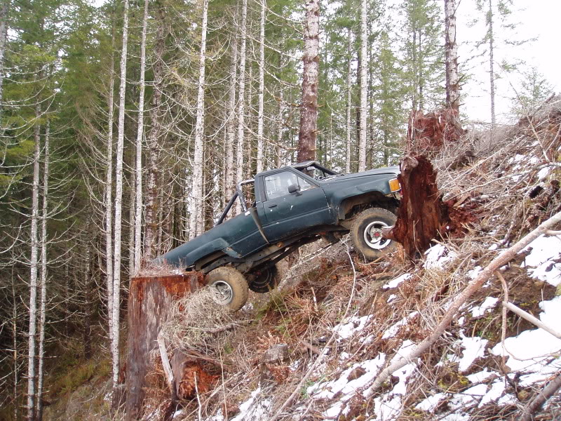

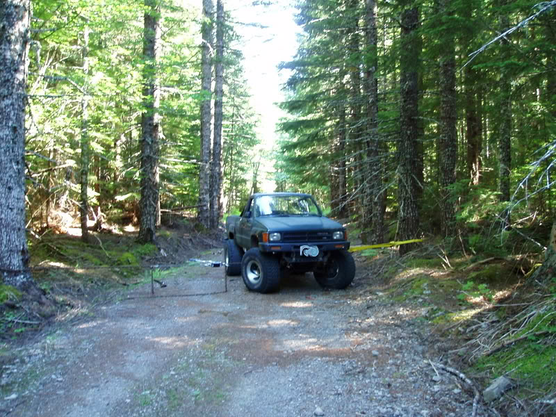

Originally Posted by Zelephant
Mudhippy, I think I checked most or the items you mentioned you broke in your accident that tweaked the frame, and all look OK. Is there any surefire way to check for a bent frame? Even if it is bent, though, there's not much I can do about it. Just rebuild as best I can and drive on it.
IIRC you're the guy that rolled his truck off a cliff and tree saved it from total oblivion, right?
Yeah, that was me. Split the frame in two on that one. That was actually the second time I'd messed the frame up. And I didn't even get to enjoy the ride on that one(I wasn't in the truck when it happened, I was in front of it working the come-along when the chain popped out of the hook). The first time(damage described in the previous post)happened when I went sliding nose first down a super steep, super slick, muddy trail and straight into a big 'ol tree root that was sticking out along side it. It caught the passenger side tire and pushed it, and everything connected to it, in by a good inch or two(depended where measured, more at the top than the bottom because of the twist it put in it). It was pretty obviously tweaked though. I crawled under it and could see where it was bowed-in between the control arms there, and all attempts to get the camber right on that side through regular adjustment procedures failed. I tried several things to correct it, the first couple of which were complete flops. No go with trying to push it back out with a Hi-Lift or a bottle jack shoved in-between the rearward LCA brackets. So then I tried using my 10,000lb. come-along like this to fix it, throwing my back out in the process. Hence the nightmare statement.

It did work to get it straight enough to align the wheels, but I didn't get around to fixing any of the cracks at the time though. Which I actually never even found 'till after the second incident.
Then, so that wouldn't happen again, I pestered the hell out of Steve at Sonoran Steel to sell me one of his Early IFS Trusses. He finally gave in and sold me one.
But, that did nothing to prevent the damage on this one.
I spent 4 1/2 months fixing that mess. Just the frame. Lot's of cutting, lot's of hammering, lot's of bending, lot's of welding pieces back together. I still haven't got it totally together yet. Still need to weld my rear bumper back on, and build a bumper and mount for the front to put the 10,000lb. winch, that I bought to get it off the hill there, on. Then put the rest of the truck back on it. Which is nowhere near ready either. Lot's of body work to go still.
If you don't have a frame truss like mine, then one way to get a rough idea if it's still pretty straight is to measure between those LCA brackets where the truss would go. It should be 17" +/- 1/4" or so. Mine measured ~16 1/8" IIRC, after the first incident. Got it pulled back out to right about 17" before I threw the truss in there.

I like your bent frame solution using the come-along, got any more info on that? Like what points on the frame you connected the straps to, how much you turned the wheel and why, etc?
Pretty much the only specifics I can give are the ones you're asking about. The strap on the driver's side was looped around the frame rail just to the rear of the UCA and connected to itself with a shackle I put in the loop at it's end. I made sure it wasn't going to pinch on the torsion bar under load by feeding the end of the strap under it and then around the frame rail before putting the shackle on to form the loop there. Then I turned the steering wheel all the way to the left so I could get the clearance needed to get a straight pull on the other frame rail with the chain without it pushing forward on the passenger side tire. Attaching the chain to that frame rail was a little more tricky because there's also some brake lines that run along top of it where I wanted to put it. I fed the hook on the end of the chain under those and under the torsion bar so it wouldn't pinch them when I pulled, and then used the hook to form a loop in the chain around the frame rail. Again I put the loop as close as I could get it to the UCA. I didn't worry too much about the fuel lines running along the inside of the frame rail there, because I figured the chain would be applying the most tension at the top and bottom corners of the frame rail. That proved to be the case, and those lines were unharmed in the process. After rigging it all up and attaching the come-along, I just pulled and pulled and pulled some more. I pulled on it 'till I thought I couldn't possibly pull it any tighter.
Then I took a breather. After which, to verify I'd given it everything I had, I tried one last tug. I got another click or two more tension on the chain, then felt/heard three rather loud pops coming from my lower back. No questions asked that was definitely as hard as I was going to be tugging on anything that day. And I regretted having taken it to that extreme for a couple good reasons. First because my back was aching something fierce at that point. Second, and if you've ever used a come-along you should already know this, it wasn't going to be easy to release the tension on the line. You see the harder you pull on those things, the harder you have to pull to get the release mechanism to activate. I knew this, but thought I still had it under control, and could figure out a way to do so.
And I eventually did. It took some carefully coordinated pushing, instead of pulling, on the handle. Or I would've had to cut the strap, and being the penny-pincher that I am, that wasn't gonna happen unless there was absolutely no other alternative.
