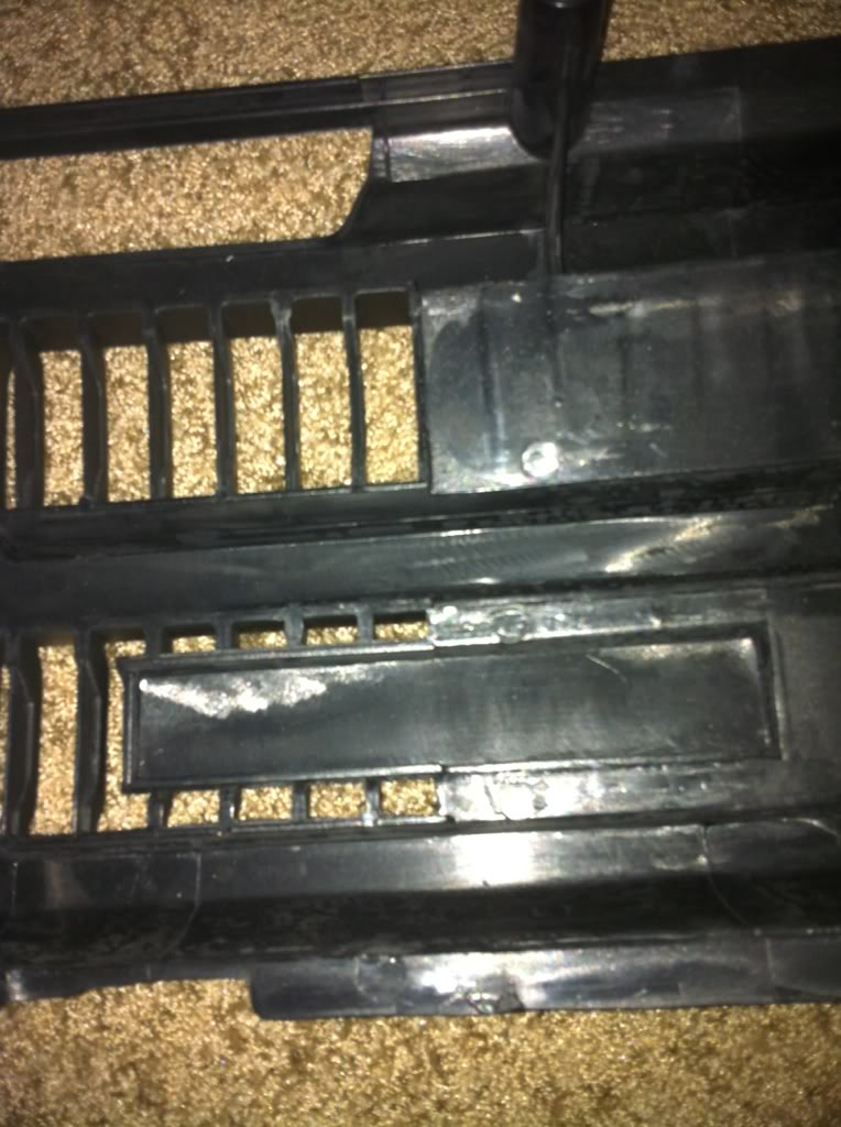

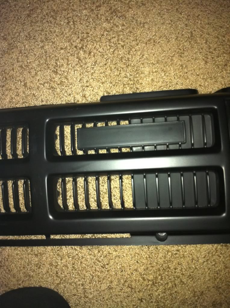

Nothing! Also my new grill looks like i can't even bolt one in without drilling a hole. Check it out. Name:  539249b4.jpg

I dont know whats going on but that doesnt look right. Is that an older style grill? The one with two vertical bars instead of just one down the middle. Maybe the older ones were like that.

I went and looked at a close up of my old 84 grille and it's an SR-5 truck and have the chrome grille, but it's like your black one and the TOYOTA is a stick on emblem, you want a pic? it'll take me not very long to post it! Carefully peel off the old TOYOTA on the chrome grille, raise a portion up and take a exacto knife and cut adhesive while continuing to lift it off so not to bend it and strip off as much as old adhesive if it's on thick with same exacto knife, go get some 3M outdoor gray color double sided foam tape at wally world if you have one (best price for a roll) don't use the indoor white kind and put some on the back covering the entire back, if emblem is wider than the foam tape put it on the edge of the emblem across the width and then fill the rest with the foam tape and take an exacto knife and trim the excess off, do it that way so dirt and bugs and water don't set there over time getting behind the emblem and will make the adhesive fail really fast, I hope I explained it right :} Good Luck :} Or go to dealer and get a new one if there available, your choice...Good Luck and have fun!!!!
Ps. Is that a new black grille or a great condition used one, looks sweet!!!! Can't wait till you get it all put together :}

On his grille, the emblem is simply adhered on not bolted on like some of the other models of grille such as mine.

The 3 tooth gille emblems are glued on. The 2 tooth grille emblems are bolt on.

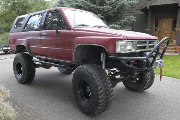

This is a 3 tooth or spaced grille Name:  PICT0152.jpg
