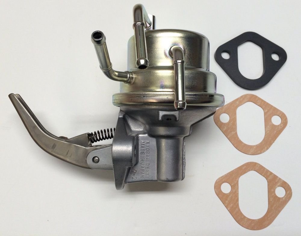

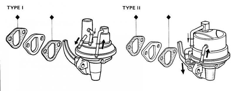

There is supposed to be a spacer between the fuel pump and the head, with gaskets on both sides of the spacer. The spacer is pretty thick piece of plastic.
Fuel Pump >> Gasket >> Spacer >> Gasket >> Head
Here is a picture from 22RE Performance showing a factory pump. The top, black piece is the spacer, the lower pieces are the gaskets.
https://22reperformance.com/22r-fuel...for-carbureted
