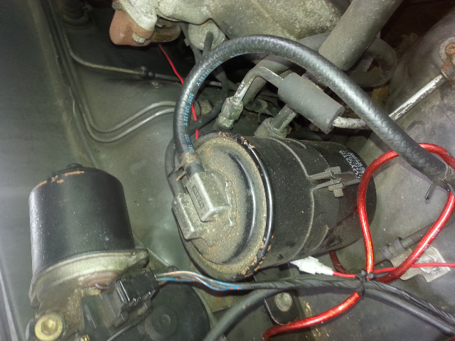

Is this it?

No. That would be your charcoal canister.
