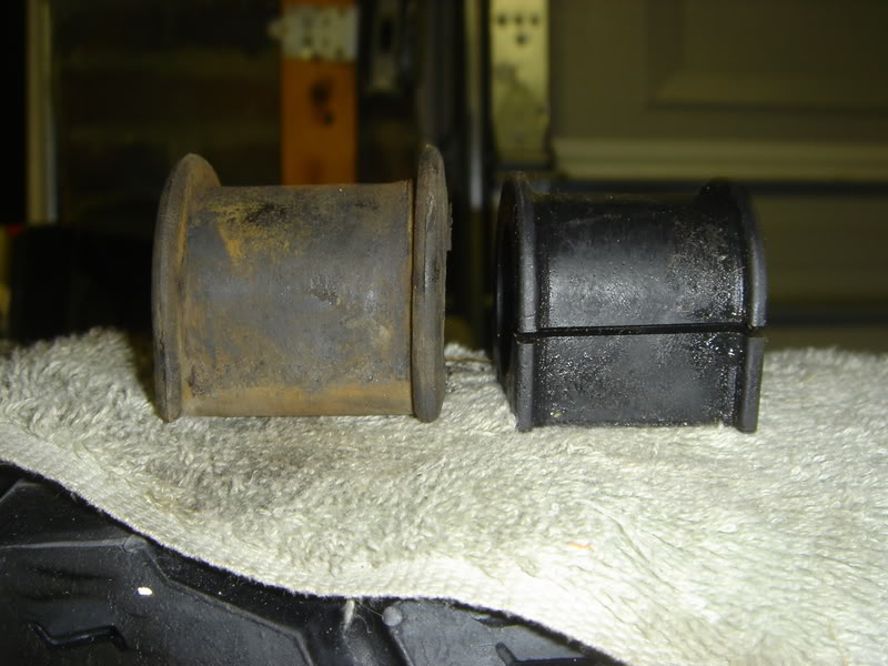

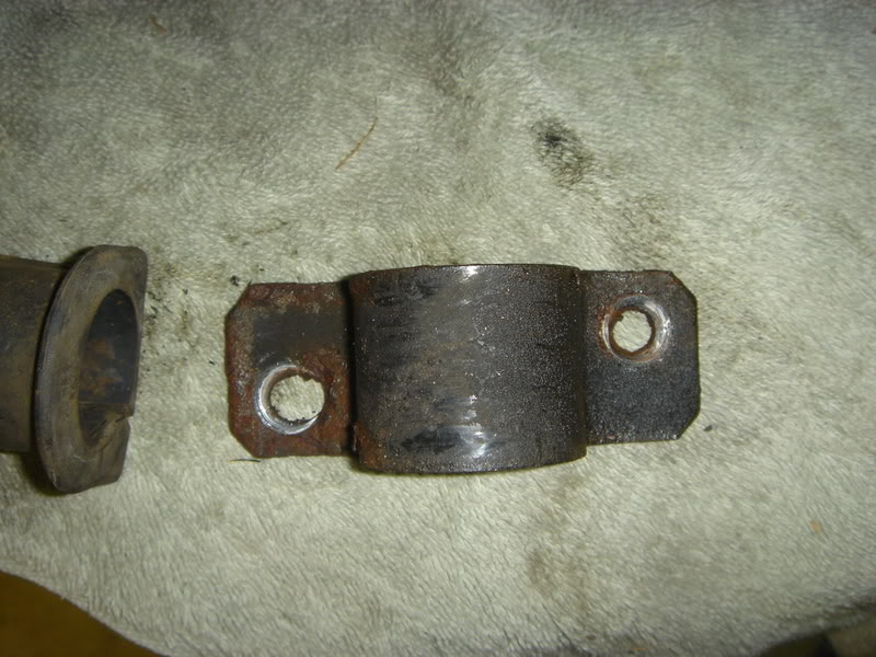

Pictures -
^ ^ ^ Notice the 27 on the mount on the lower right (upside down)?

I guess some sway bars are bigger. I'd just stay with those OEM bushings and bracket, they look ok.

That's the "ok" bushing. The other one pretty much disintegrated as soon as I unbolted it. Also, my issue is my end link is snapped.
