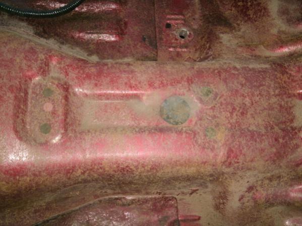

Parts are interchangeable with 2nd gen 4runner. Mine all came from a 4runner.
Console mounts
seatbelt mount
You will find there are dimples where you need to drill out and add the weldnut.
If you can not weld in nuts use a stack of washers to disperse the load
