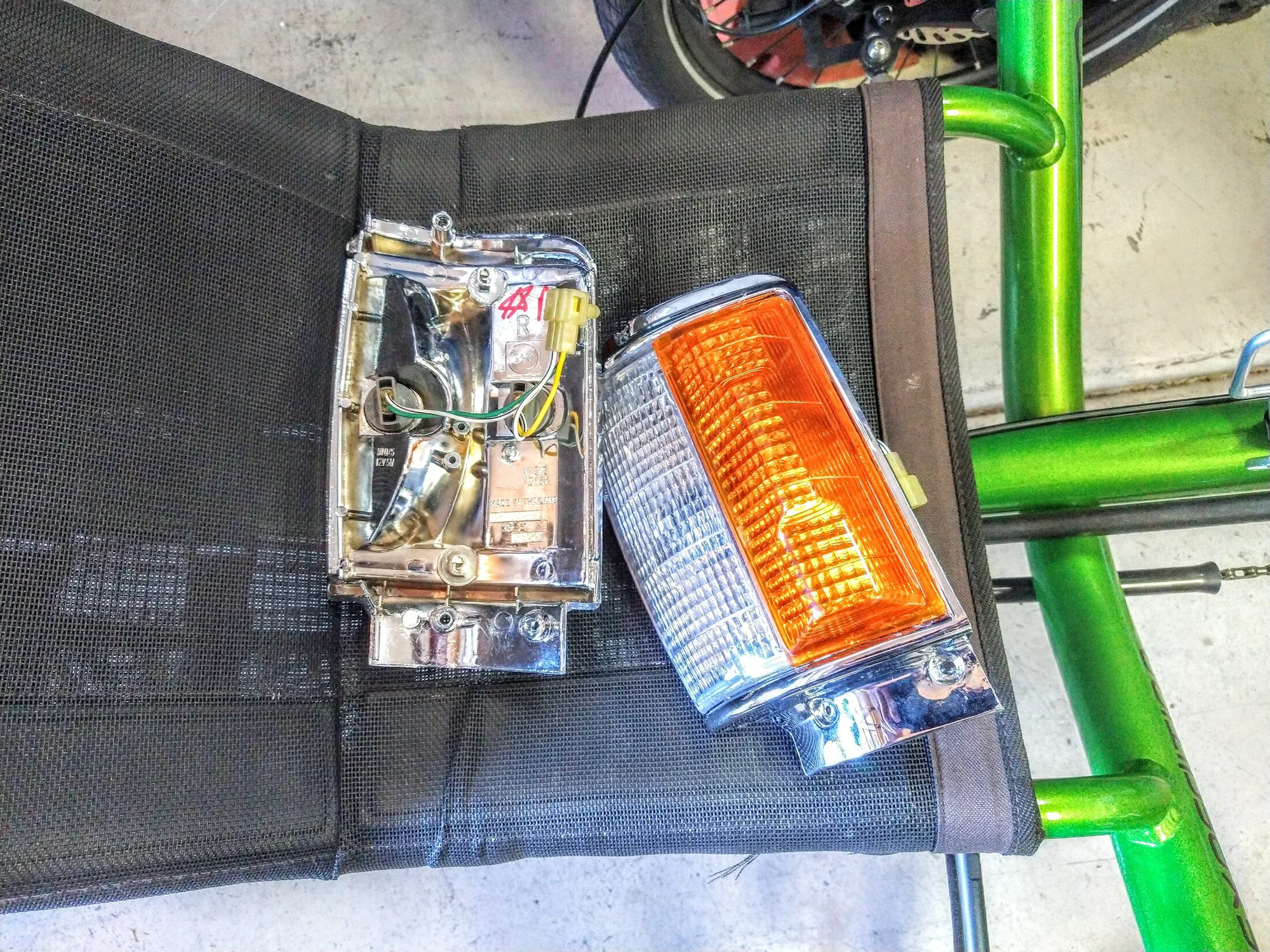

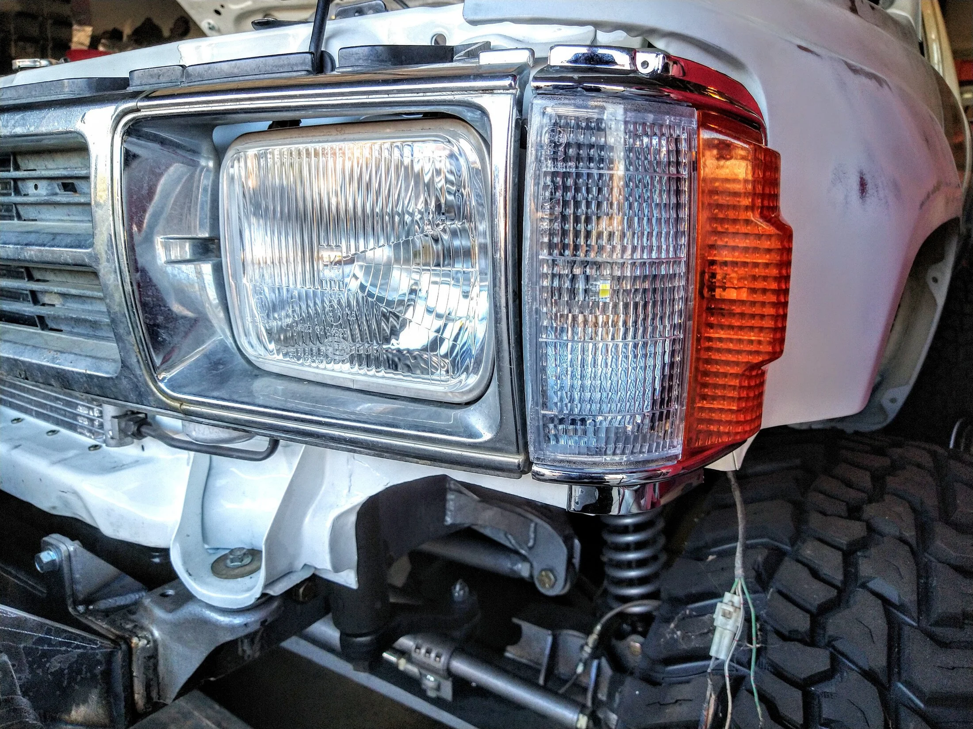

I've modified housings to work like mentioned. On my current (never ending) build I bought a set of these awesome JDM (Japanese Domestic Market) lights from www.vintageteqparts.com . I just looked and they are no longer offered from him. Maybe check eBay???
