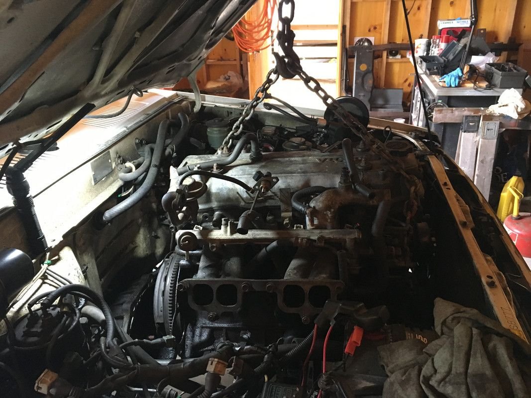

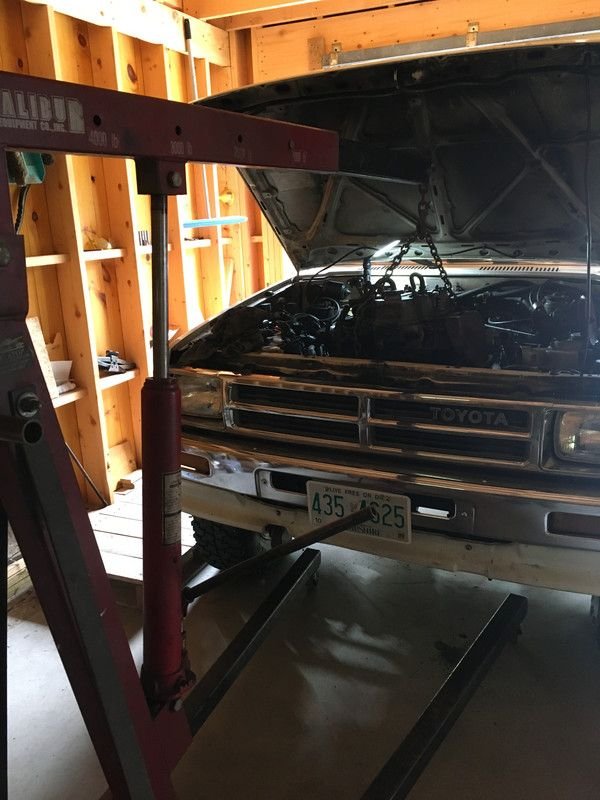

Last Friday I got everything disconnected from the engine. I went out of town for the weekend and got started back on the Yota today (Tuesday). Hooked the chain to the engine and the cherry picker and started to pull the engine and the only thing I missed when I disconnected everything (almost) was the little ground wire on the back of the head and of course that steel bolt was seized in the aluminum head and twisted off. I'll have to drill that out before I put the engine back in. Had to go to Lowe's to get 2ea. M12-1.25 x 80mm bolts to bolt the engine onto the engine stand. Got the engine mounted on the engine stand and called it a day. TTFN

I forget which bolt that is that the ground strap goes to, but if not critical for another reason, i’d ignore it and put the ground on another one.
It is critical. It is one of four bolts that hold a water manifold into the back of the head.
