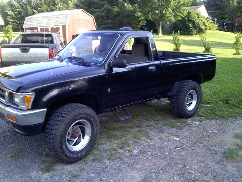

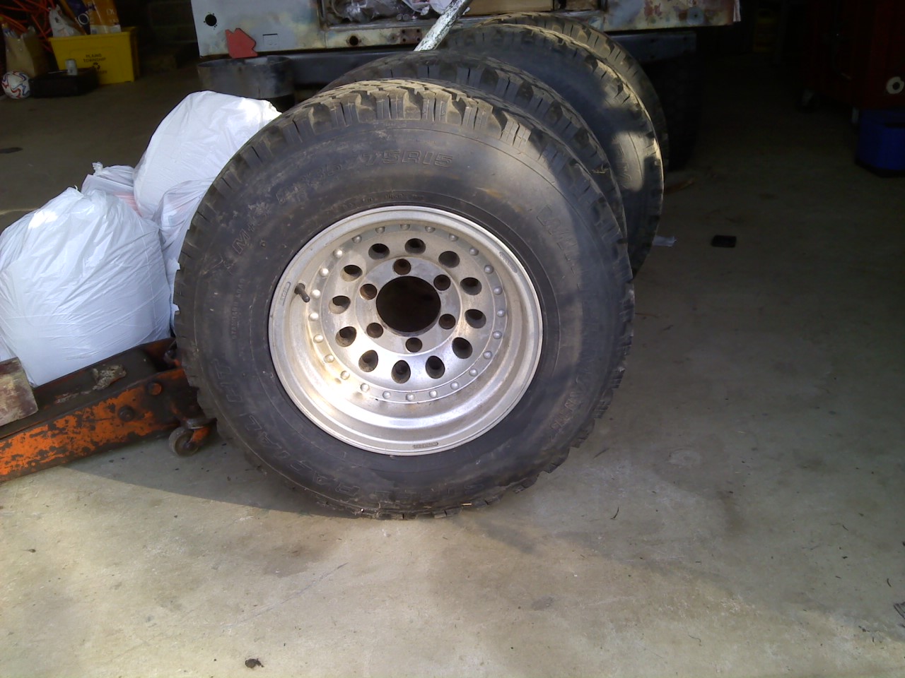

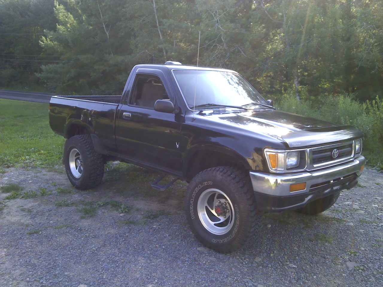

a few pics of the truck

FJ 60 wheels are usually 15x7, with a 3 3/8 backspacing. This would make your wheel stick out over 2.5 inches.
In order to get the wheel to tuck in more, you will need a wheel with more backspacing. Usually a 94 with IFS came with a wheel that had a backspacing of 4 3/4.
I would find a wheel from a IFS Toyota truck or 4runner to start out with. Then you won't have much "fender" to put over it...
Edit: That third picture of the rim and tire is not a OEM Toyota landcruiser wheel...It's aftermarket.

the wheel/tire combo in the pics won't pass inspection? man, glad we don't have that nonsense (but we get screwed with stuff like emissions). those outlaw ii's in the 3rd pic are pretty much what i have on my truck, but with 33x12.5s and less backspacing - puts the tire out of fender around 1.5", a 31x10.5 tire would probably be around 3/4-1" sticking out still.

thanks all, I tried the cruiser wheels I have with 30x9.50 on them and the tire "tread" would only stick out. The law says the tread has to be covered but that would pass. I'm currently about 1.5" at the tread and 2+ at the bulge with the outlaws..
