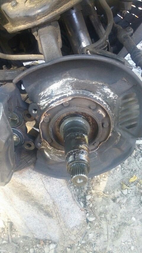

A couple weeks after doing all this, which im currently dealing with, my pass. Side front wheel locked up when pulling out of a parking spot. When i pulled into the gas station i heard a loud popping noise and parked and didnt see anything out of the ordinary and when i went to leave the tire locked up. Now i literally just got nice pretty new 31x10.50 mud terrains on this thing saturday, so sunday i took it though a rough little trail just to finally see what my yota could do for the first time. Tommorrow i plan on tearing into the front end to see whats going on and i will post pics and info on what i do to it later. Any thoughts on this would be appreciated.

Found the issue... I had a bolt come loose where the rotor connects to the hub and it got caught between my rotor and brake shield ( not sure if thats the exact name.) But thats what was stopping my tire from spinning. Since i was under there i went ahead and did the upper and lower balljoints and cv axle. The old cv axle was in horrible condition anyways and need to be replaced. Heres some pics.
Where the bolt came from.
The bolt that came out. It got chopped up pretty bad.
