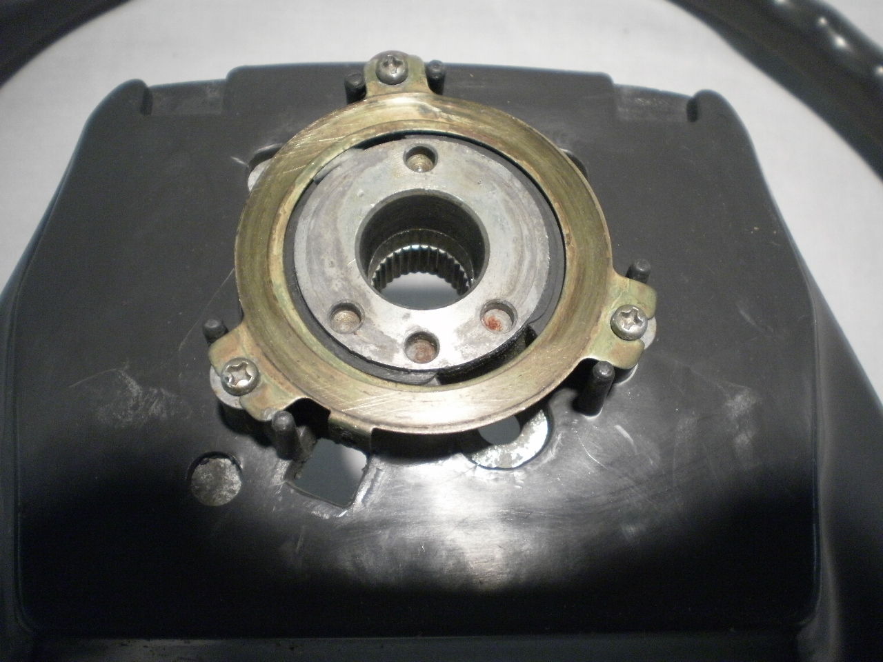

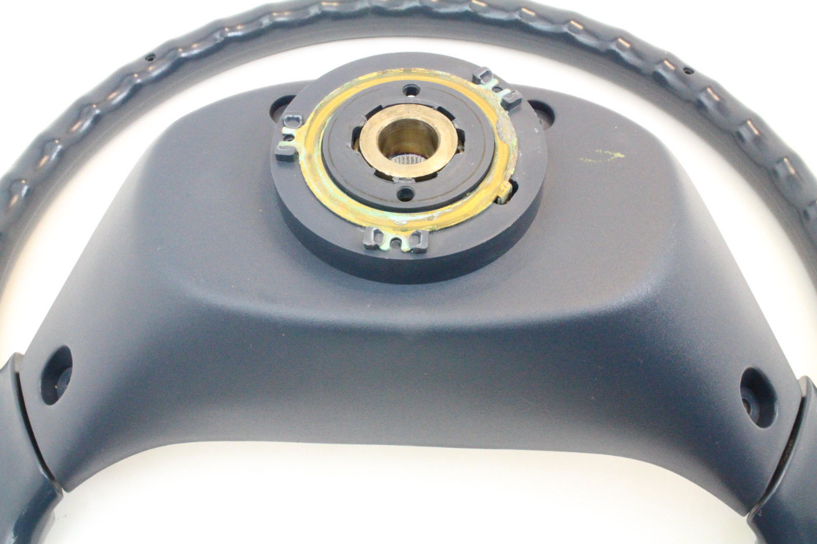

I’m reviving an old thread because there doesn’t seem to have been answered and because I am in a similar position now. I removed the horn pad from my 84 to work on its horn issue and I found that along with the cracked steering wheel, there are a lot of cracks under the pad. Not so bad that anything would fail but it’s kind of annoying to know they are there. Since I have to remove it I figure it would be a good time to put on a better replacement and maybe upgrade the look and feel some. My search about upgrading got me to this thread.
I my search for something better looking and Toyota (I don’t feel like doing the aftermarket thing with this truck) I came across the blue wheel pictured here. It is simple and somewhat nicer looking, design wise, than the 84 wheel IMO. The one in the pic, on ebay, is from a 1994 and supposedly would fit “89-95 Pickup – 90-95 4Runner”.
Allegedly, based solely on what I saw in ebay (yeah, not the most reliable source) a 1984 wheel will cross up to a 1989, but I don’t know this for sure.
QUESTION 1: If that is correct will a 90s wheel cross down to an 84?

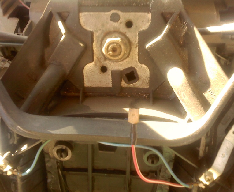

Note that the 84-89 wheels have a square hole where I think the horn wire goes. I can’t say that for sure because the wire to mine was not connected, but it is the only place it would fit. Note that the backs of the 2 wheels are different but . . . QUESTION 2: Are they compatible?
I would imagine the shaft diameter and spline counts are the same, but again I don’t “know” this. QUESTION 3: Can anyone confirm this?
QUESTION 4: Has anyone done this swap (mid 80s steering wheel to a mid 90s wheel)? Is it a simple swap or ? ? ?
Attached Thumbnails Factory steering wheel swaps??-toy-wheel-front.jpg   Factory steering wheel swaps??-toy-wheel-back.jpg   Factory steering wheel swaps??-toy-wheel-89-back-sq-hole.jpg   Factory steering wheel swaps??-toy-wheel-89-sq-hole.jpg

I poked around this issue not long ago, you might have seen me and space-junk talking about it. We're both thinking to swap to the early 90 sr5 wheel and shaft. Padded vinyl wheel, better tilt mechanism, no key lock button ECT..
My research turned up the splines and diameter are the same, however the horn ring is a different diameter or was it distance I've forgotten now but both are solvable. Either spacers or a ring swap will be needed to use the newer model wheel on the older shaft.
QA
Let's just say probably safe to assume yes to all. Haven't done it however. There wouldn't be any reason to retool the spline part. There are likely difference in the shaft lengths between various models car vs trucks and such but nothing a bit of cut and weld wouldn't overcome.
Give me a minute to go trudge through the mud and I will snap a picture of my 86 gutts for reference of the Spade connector you're missing.

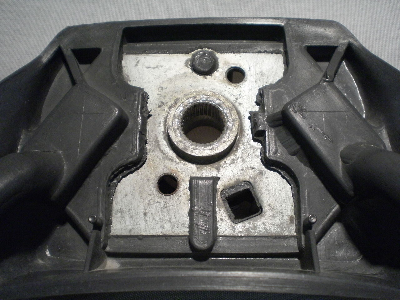

This is an 86 4runner. The horn ring Spade connector is pressed through the back side of the plastic, to the left you can see one of the ring mounting screws.
this is a mid-early 90 4runner
Steering wheel trim, front facing cover
Primered steering wheel
Thought I had more or better photos, one with the ring attached, but this is all I have on hand. Hopefully it's helpful.

This pic is of my current wheel with the pad off - just a bit different.

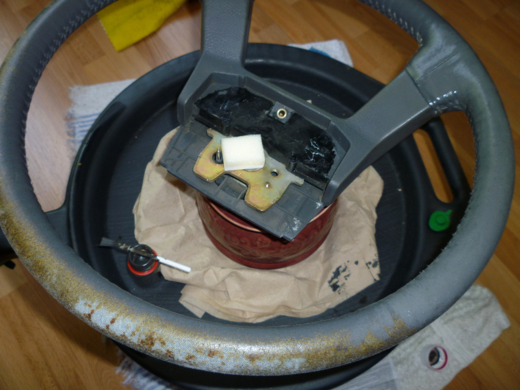

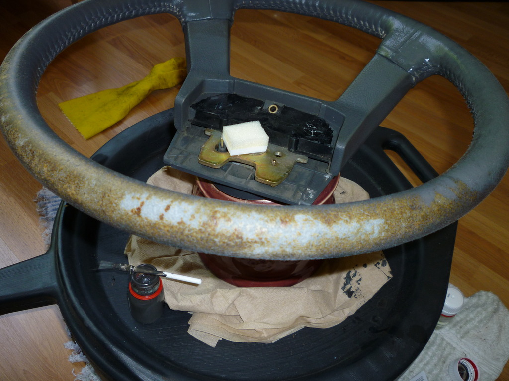

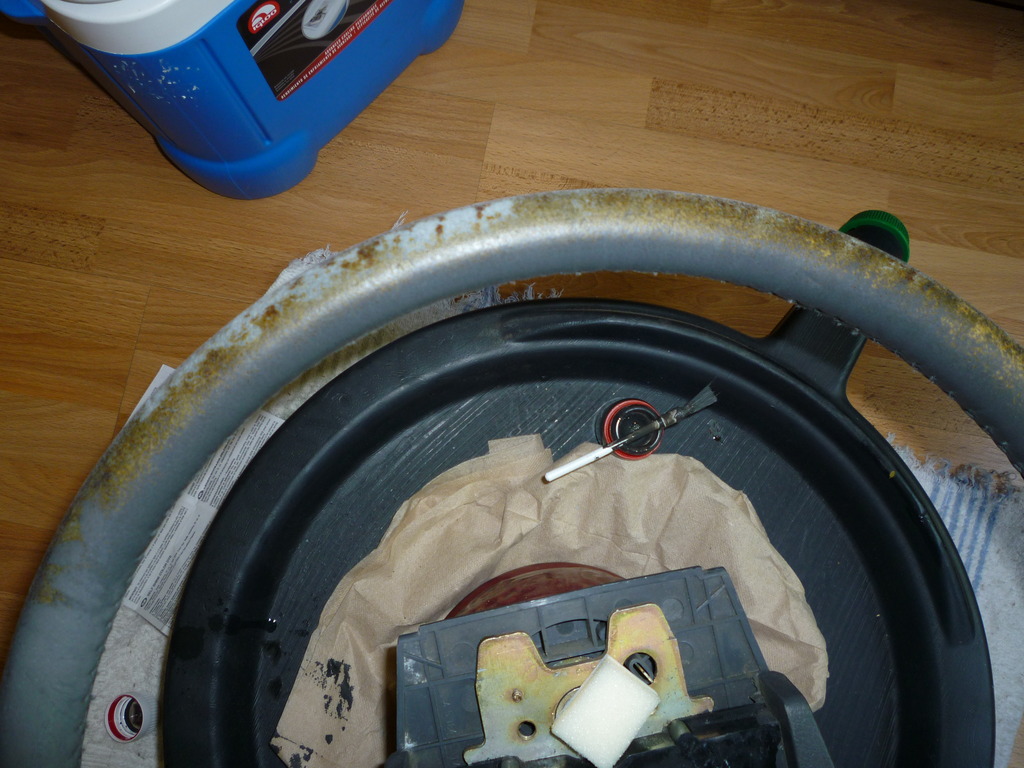

I got a grey leather steering wheel from a '89 1st gen 4runner being parted out.
Old Feb 5, 2017 | 11:52 AM
maco35's Avatar
Joined: Feb 2010
Posts: 504
From: L.A. CA.
The way i got it. Name:  P1060420.jpg
Size:  229.5 KB Name:  P1060419.jpg
Size:  203.2 KB Name:  P1060418.jpg
