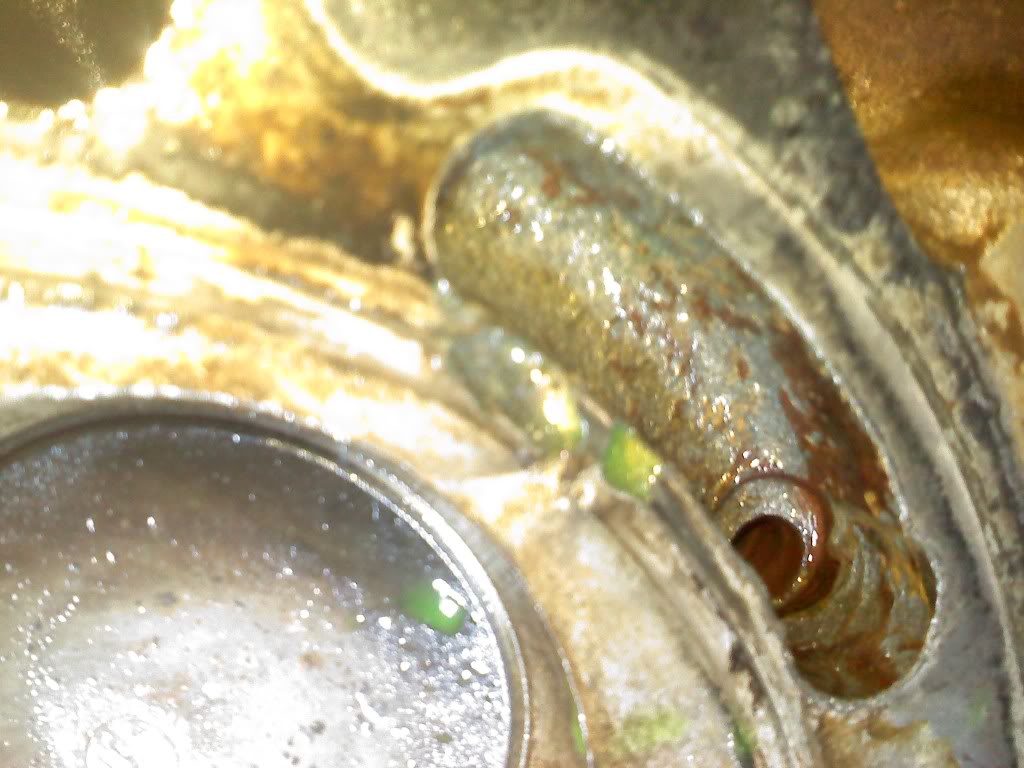

Yeah its pretty bad I wouldn't mind having it filled in and shaved but I am worried that this could happen on another cylinder after a couple years. Here is a pic or two of the damage.

I been having much the same experience as you, both with getting so much confidence from yotatech that I tore down my 22RE
to find the same corrosion of the head. (Apparently water corrodes aluminum, and the glycol does not, so run only coolant, no water....new thread maybe?)
I had my head welded and shaved, 110 candaian dollars. A lot cheaper than new...
Have positive experience with Engnbldr.com, and getting parts for the block from there.
0.2 ca cents
I thought about that as a solution as well, what stopped me was the fear of future pitting on the other cylinders. I currently think the pitting was a result of a bad coolant mixture and the lack of a ground from the head to the firewall. If I am correct that would mean the entire structure of the head is compromised.
