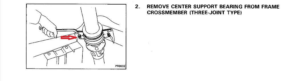

I just replaced mine last summer. I was able to get the new, OEM, one from the local dealership, no trouble. I figured that if the original lasted 325,000 miles, the new one should last at least that long too
Just make sure that the little notch in the mounting plate is oriented correctly. It should be pointed towords the rear of the truck.
Note: Rear of vehicle is to the bottom of the picture.
Good luck!
