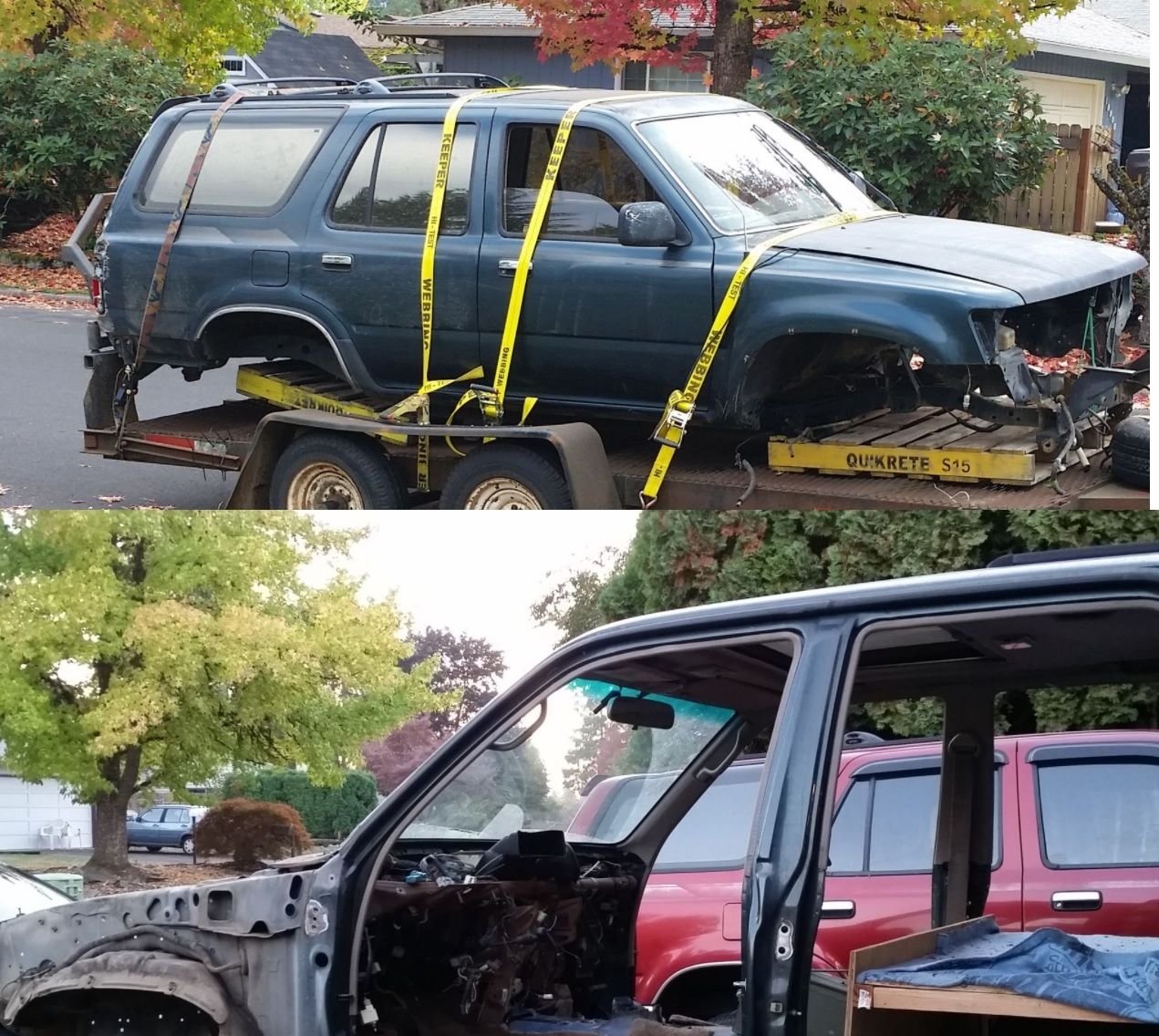

i just popped the inner kick panel on both sides, when my half doors showed up it only took me 2 hours completely strip it
