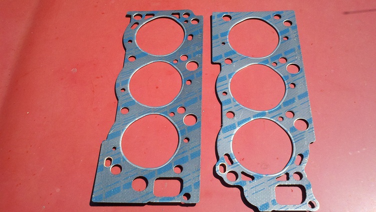

Here are a few pictures of clogged gaskets, to give you an idea of what you are up against.

Of course these are 22r-series gaskets so yours are a little bit different
http://i173.photobucket.com/albums/w...A/P5010008.jpg
should look closer to this
http://www.n7uic.com/pictures/fel-pro1.jpg

So I see the clogged up gaskets, but what's the resolution if that is the problem? New gasket, flush, other?

Sorry missed a direct question. Blocked passages lead to hot spots, hot spots lead to gasket failure or a cracked block (Usually the former).Originally Posted by WestSideVB

I think we are pretty set on dropping in a crate engine if it comes down to head gasket. 1500 to do the gasket fairly decent with a top end quasi rebuild and replacing the right stuff. 3K installed is what we were looking at for the crate with MLS gasket, good studs, from a reputable machine shop that should get the job done right. I tell her you don't put 3k into a vehicle that's worth 3k after the work; I lost that argument. The truck is in really good shape cosmetically. Couple minor body issues but good, and inside very good for 20 years old.
The fan shroud I cracked is 100 at the dealer, any cheep alternatives? JBWeld and a splint? Maybe hit the junkyard? I'm planning on testing the new fan clutch with it off, I know it directs the air some but I'm thinking not enough to invalidate the test????
i pulled apart a 1990 dodge 318 engine a few months back. most the water ports where the head meets the block were clogged. i pressure washed the crap out of the ports in the block to try to clean some of that crap out. that dislodged some stuff but not all of it. i highly doubt a coolant flush would remove any clogs you have.
i say do head gasket repair. you're obviously showing good results with the compression test which means your bottom end is still good. might as well just do the head gasket replacement because it'll happen sooner or later, especially since you are having over heating issues. the last thing you need is is to blow the head gasket the rest of the way and completely destroy the aluminum heads with over heating or destroying lower end with milky oil. probably cost you less than 300 bucks if you do it yourself. there are probably more head gasket replacement threads on the 3.0 engine that there is on any other engine out there. so you'll have tons of references to do it yourself
^^ what he said DIY it, for that 3k you can buy another 4runner and do the HG job twice and you two will have matching gas guzzlers
I might up the cost estimate to 500, not sure if he factored in tools and consumables. Still very reasonable, and plenty of walk-thru and howtos. And the bit about someone noticing was mostly a joke, but sure if you look you can find someone to loan you some driveway space.
I might up the cost estimate to 500, not sure if he factored in tools and consumables. Still very reasonable, and plenty of walk-thru and howtos. And the bit about someone noticing was mostly a joke, but sure if you look you can find someone to loan you some driveway space.Registered User
right....... i was thinking 300 just for the parts. go to rockauto.com and check out head gasket kits. it'll have everything you need to do it. i also didnt count in machine work. while you have the heads off, get them them reworked by a machine shop. probably cost you another 150, 200 or so. they should clean them, resurface the valve seats, install new valve seals, and plane them flat if they are warped. should also include inspection for cracks.
