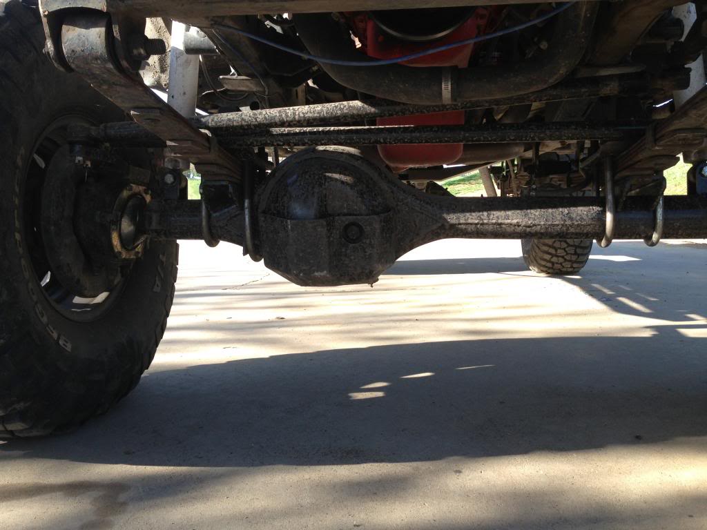

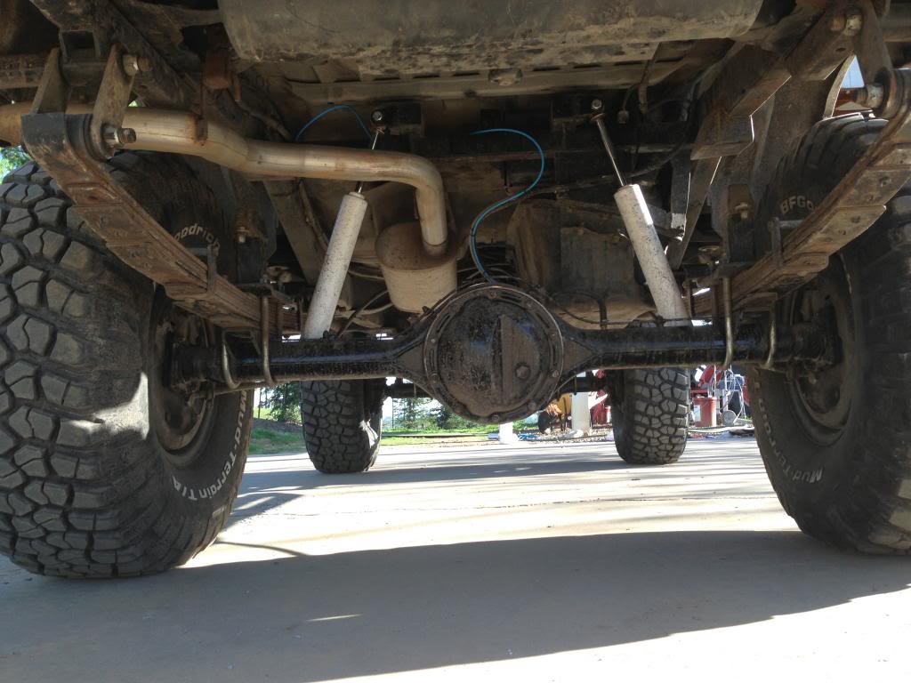

I just did my first gear setup. Time will tell how good i did. The thought of doing them always scared me. Glad i did it. Its not hard , just takes along time being a first timer. And you need some tools to do it. Press , torque wrench, bearing pullers. Or you could buy the tools with the money you will be saving . Look at lots of pictures of patterns and make big shim movements in the beginning to see whats happening. First try learning on the front. I think the rear needs to be setup the best so learn on the front. If you can't do it or your not sure then take it to someone else after you tried . Get a junk 3rd tear it apart and see if you can put it back together.
While i was at it , i built a centered land cruiser rear axle and a
cut-n-turn , shave fj60 front axle too. Fun Fun Fun.Name:  IMG_1281_zps9beadaaf.jpg
