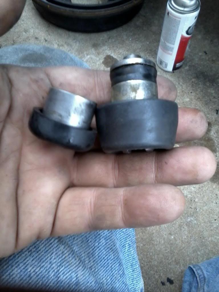

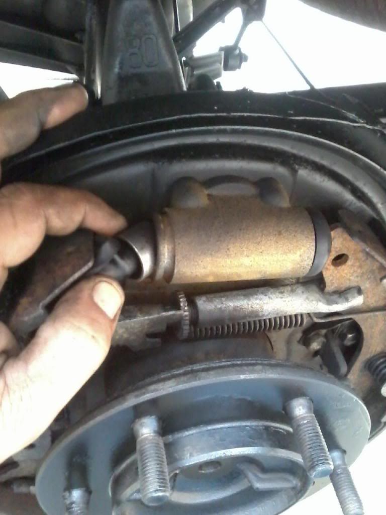

I had a slave cylinder to leak so I replaced it with a parts store just to get it running again. After hitting the brakes sevral times, I felt the pedal give alot. I had to go further down the road and my brake light came on and could tell my brakes were getting bad.
I pulled over and checked all of the brakes and the driver rear brake had fluid everywhere. The one that I had changed the slave cylinder on. Rear brakes are not my strongest area, so I figured I had done something wrong. After several times I had a friend that knows rear brakes to help me and when we compared an old factory cylinder to the parts store slave cylinder, we noticed that the parts store cylinder was correct for bolting up to the hub, but the pistons were not long enough to stay in the cylinder. I normally check when using parts stores parts, but this time I figured it was right as it bolted up and everything. Parts stores quality is going down hill.
Parts Stores Cylinder. The piston would not stay in.
The one on the right is what I should of had all along. The one on the left is the parts store piston.
