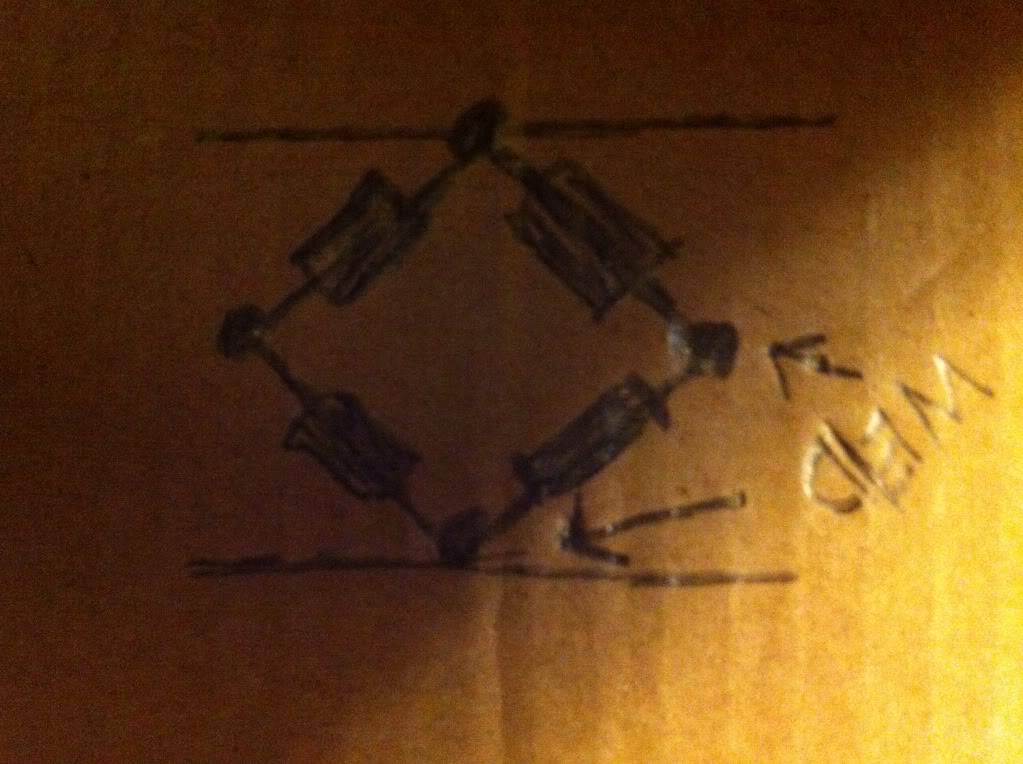

The best place to cut them is just at the back of the cab. There the same from there back on 84-88. Make you you cut them straight and measure them perfectly. Butt them up and weld the top and bottom. After that cut you out some diamond shaped plates. Place those on both inner and outer frame sides. Weld each corner of the diamond. Then weld the sides of the diamond although dont weld it solid. It was be able to flex if not it will break. Here's a pic if you don't understand.

You never weld any frame splice vertical .
Although on something as light as these trucks you could no doubt get away with it but life time habits are hard to overcome.
But people need to learn these things.
