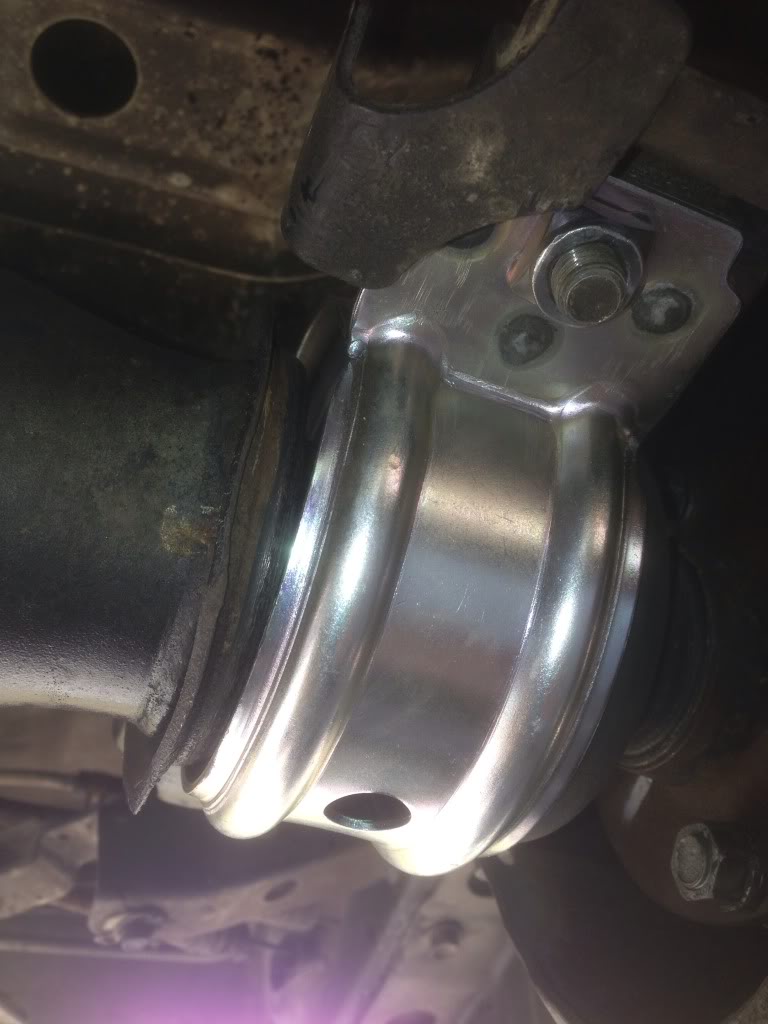

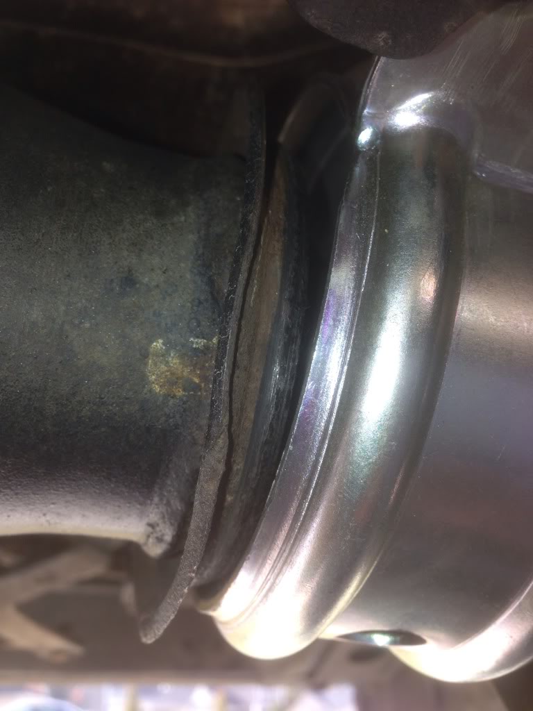

Ok gents, so I'm really stumped on this and I need some help. I've read ALL applicable threads related to my issue and there seems to be no help in them. So, 89 v6 xtracab 4x4...center support bearing went out recently. Replaced it. Went bad again in two weeks. Replaced it. Now less than 2 weeks later, the end of the driveshaft is rubbing on the metal portion of the CSB, which is what it was doing with the first replacement as well. The CSB assembly looks as if the front is angled towards the bottom of the bed and the rubber grommet is bulging out the rear of the CSB. It almost looks as if the crossmember portion of the CSB mount is bent torwards the bottom of the bed. The most recent replacement to go bad was the one from driveline parts.com, the $40 one. First one was the advance auto one for $135, yeah, never again. Truck has stock suspension and I'm running 32x11.50 BFG km2s. I'm stumped. Please help. Got a couple of pics. Let me know if you need a better angle...😕 Name:  2AAA5EC4-F557-4AE0-98DC-D2A56409F738-202-0000000AC90D46F2_zps89a3f6fb.jpg

Yes, I hear the driveshaft rubbing the metal outer portion of the CSB. The way the CSB mounts to the crossmember allows it to be ok for a while and the odd angle eventually wears the CSB out and pulls the bearing out of the center of the grommet...It's not a balancing issue though.....

U joints are tight, and no slop in the slip yoke. I haven't had the driveshaft balanced since I owned the truck, but I never noticed any vibration. It hasn't been off road so I know it hasn't contacted anything throwing it off balance. I installed the CSB with the cutouts in the flange facing towards the rear of the truck which is the way specified in the FSM. If you look at the way most of the rubber grommet is bulging out of the rear of the CSM, is this normal? When I get the new CSB I may have to drill out new mounting holes where the CSB mounts to the crossmember to put the bearing into proper alignment, but this shouldn't seem necessary. I would just put a one piece driveshaft in but I'm worried about the pinion angle and really don't want to have to shim the rear axle to make up for losing the double cardan joint. When replacing the last 2 CSB's I was VERY careful to mark the shaft and put it back together the same way it came apart. Still puzzled....

I had my buddy press mine on to the shaft for me and it was backwards when I went to hang it. Would have been easy to mount it that way if it didn't have the hangers on it I would have never noticed as the bolts still lined right up. My money says it's on backwards.
Old Nov 6, 2013 | 08:24 AM
hossdog's Avatar
Joined: Sep 2013
Posts: 12
Also when I finally got mine in right it still seemed like it wasn't perfectly aligned, so I took a bar and carefully pried between it and the the frame until it bent slightly so that the it lined up right. Then went for a drive and checked it again. I think that assuming these are going to line up just perfect out of a box from NAPA might be reaching a little.
