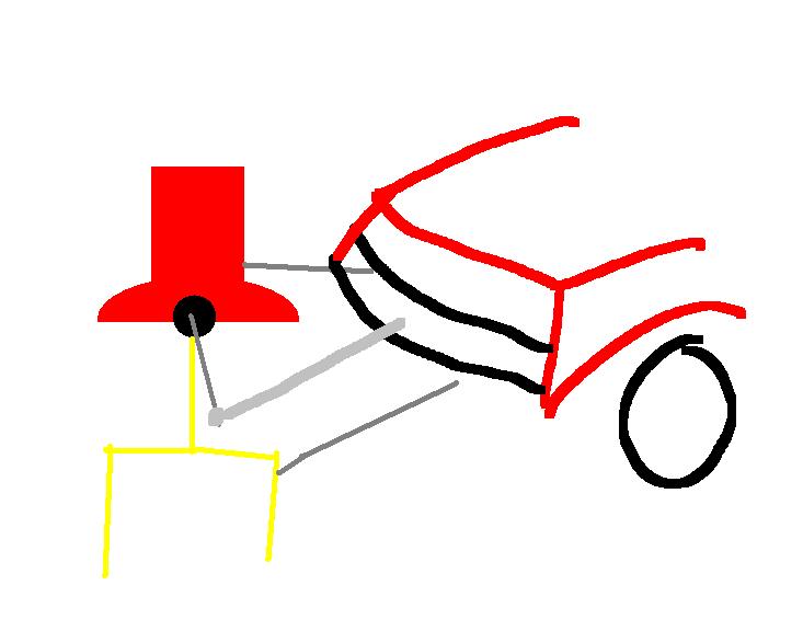

I need to keep the whole engine stand from moving under the force of an 8000lbs winch, that's a lot of power. There's no really way to do that w/o another truck or cement anchors. There's nothing in the garage I would trust anchoring it to...
Unless I put something between the engine and the front of my truck. <BR>
The darker grey lines are pipes or wood or w/e holding the engine from the front of the truck

I like the way your thinkin! You could also chain the engine/stand to another truck on the other side...
